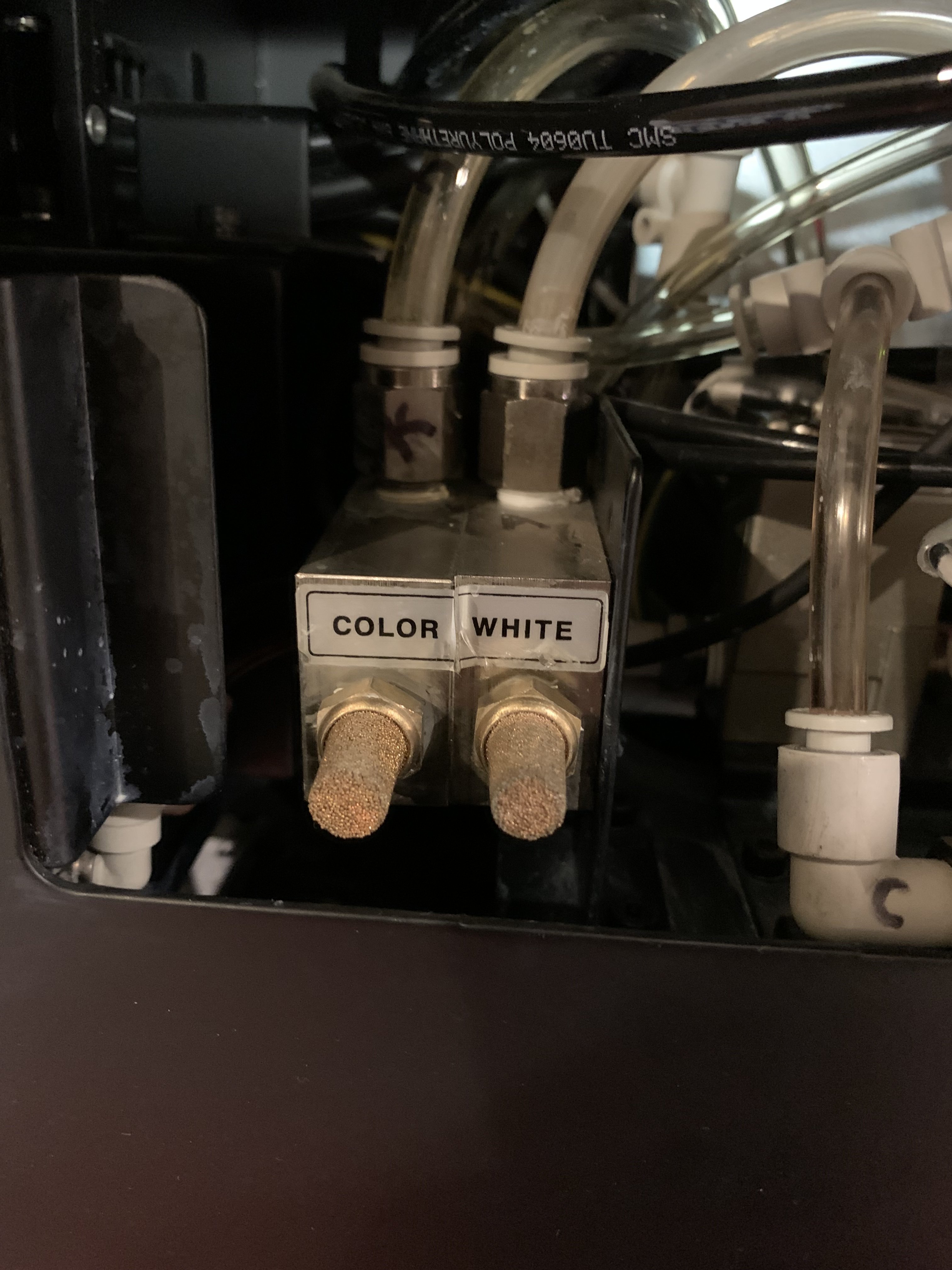

Ok, thank you Ken! So I'm reading through the operator manual and trying to figure out how to do the solution flush. It says to push onto the "Flush button" on the back of carriage. Where is this flush button? Ive opened the back panel and only see two small white buttons, one labeled color and one labeled white. When I press on the color one it looks like its performing a purge. I don't get any solution coming out. Am I missing where this magic flush button is located?
Madams-Yes the printheads are attached to the valves along the front and there is a solution valve and tank along with the rest of the inks
If it is set up like mine (which I think it is) all valves are set to solution when the machine is off, except for the far right hand valve which is set to ink. Otherwise, all the ink drains out of the heads, and if the power is off, there is no pumping going on to replace which will set up, and not make you a happy person.
Have the vacuum pressure like you normally want it to operate (.38-.46 depending on your elevation) higher elevation is higher numbers.
Turn all valves to ink, then turn down the left two (K and C), then turn down the far right to the solution, that should cause almost immediate dripping from those two heads, but possibly not.
Go to the back of the back panel on the carriage, and push the little button marked color, which will purge the color faster on those two heads. Push only a few seconds at a time until you are coming out with clear flushing solution, then go back, turn the two valves back up, and move to the next two, etc. etc.
This is all I have back there…no buttons though. Can someone help me with this? 8100058E-1136-401F-83A0-01F29E740F1A.jpeg
