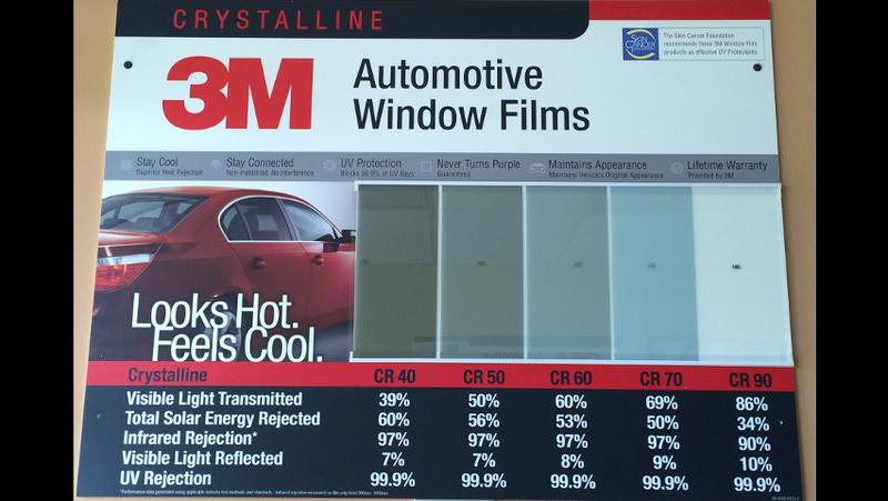

http://solutions.3m.com/wps/portal/...me/Products/WindowFilm/CrystallineWindowFilm/
I have the CR90 on my car windows.

Does the asterisk by the infrared rejection specs denote:†TSER On Angle calculated at 60 degrees
††IR for wavelength range of 900-1000 nm?
boxerbay
follow the link to 3M website. has all the info right there.
3M™ Crystalline Automotive Window Films 70
68% Visible Light Transmitted
50% Total Solar Energy Rejected
59% On Angle†
97% Infrared Rejected††
38% Solar Heat Reduction
9% Visible Light Reflection Int.
9% Visible Light Reflection Ext.
99.9% UV Rejected
23% Glare Reduction
