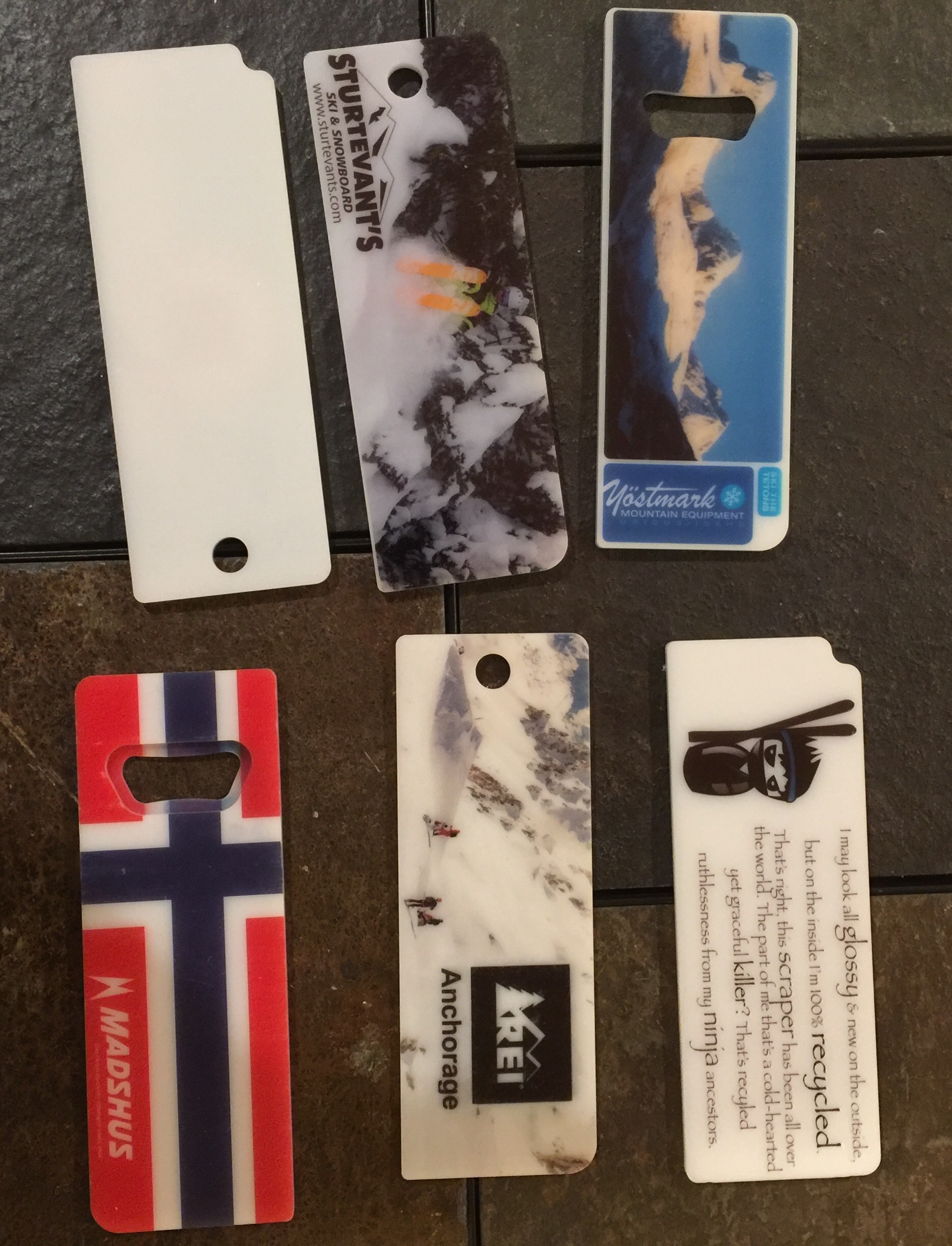

I have not prototypes but I do know what the previous owners of the product did do. It was the eco solvent printing with a Neoflex flatbed.

I have uploaded a pic to show what we are doing.
