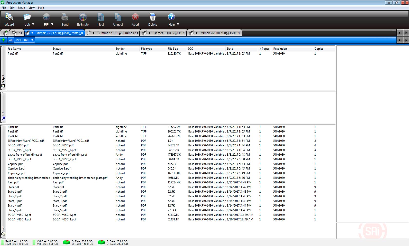

Nice.... Seems to be working fine for us so far. One issue that is bugging us to ne end though is production manager no longer shows the percentage complete on printing or RIP jobs. I cannot see where I can see that in PM at all. If we send a job from Designer you CAN see the percentage in the RIP and PRINT dialog screens though. But that only seems to show for jobs you sent, does not show a job I just sent directly from within PM. Highly annoying when you have multiple designers all needing to send jobs at certain times and no one can tell if the Mimaki is printing or not without going out into the print room and physically looking at it.
jayhawksigns
That's interesting. Not sure if its a printer thing but our L560 tab has an area that shows jobs being ripped and jobs being sent to the printer and you can monitor the progress there for each. In the middle of a job right now and it showing a percentage on our screen for the completion of the job.
Wonder what changed, I know the presentation of the information is slightly different from previous versions and took a little bit to adapt.
SightLine
No idea.... this is what ours looks like right now. JV33 has a print job running on it about halfway through (part2 - one we have been printing over and over for months). I can right click and see the field chooser but nothing seems to show what the job progress is. Does not matter which machine or who sends the job.
jayhawksigns
Right where it says Status and it has your filename again is where it shows the print status on my computer. Same version of Flexi, different printer.
SightLine
Got me thinking. Going to fiddle with some settings.... always smart to do while things are printing right? lol
Well...... I remembered there is a "theme" setting in the general PM options. That did not do anything. Fiddled with Windows display settings.... no help.
Then back in PM I right clicked and fiddled with the field chooser and turned a couple of an on and that did it!
Oddly the "Status" field I did not mess with though but now all the sudden instead of showing the file name in the status field like it has been for quite a while now there is no file name and the status progress bar is back. No idea why and I'm not going to fiddle anymore. Just glad it came back. My guess though is some of the fields you can select are buggered up in the code and can cause others to not display right or something.
