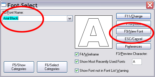

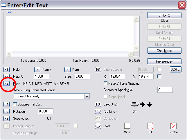

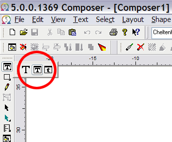

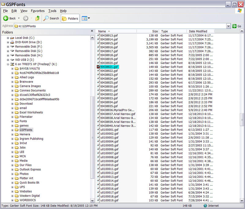

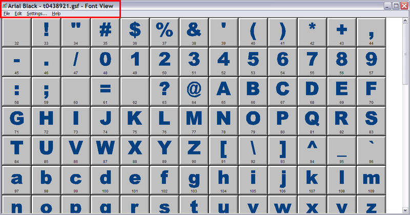

Never had the problem but here's how to find the file name of the font ...
Select the second text entry tool and click in your workspace.
Click on the Font button to bring up the Font Select dialog.
Select the font from the drop down menu and then click on the View Font button.
The font file name is shown at the top of the Font View window.
Go to the GSPFonts folder to locate and delete the font.

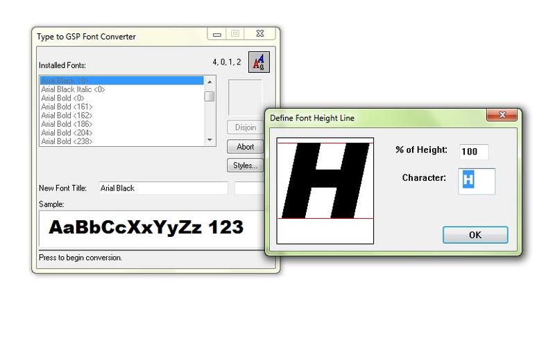

So, I found where the .gsp fonts were, deleted ARIAL BLACK and tried to re-convert it with my GSP converter and it's wanting to put it back in as italic. I attached a screenshot of what my converter looks like... the first preview looks normal but when I click convert it is italic!
Never had it happen. As I understand the TTF Converter, it is simply converting to GSF format the glyphs that are there.
What happens if you convert the Arial Black italic version? Is it also italic?
You might want to try uninstalling the Arial Black Italic version from your Windows fonts and also double clicking the Roman version to see if it is correct. If it is, try converting it again without the Italic version being there to interfere.
