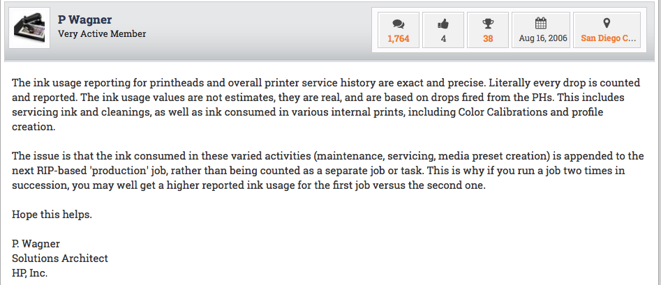

I received a useful post from HP which contradicts what I was told by the tech on the phone but does make sense. I did also look at the ink levels from the printer info tab in Flexi before and after the job and they were the same as what the HP said it used for end. So I think it's case close for us for now other trying to bring down ink usage generally through profiles and curves etc.
Steve

I don't know if I'd Believe him. Goto your accounting web tab, click help and read the bottom. If it were exact, hp wouldn't say within 15% accurate, with warnings everywhere that they're just estimates.
