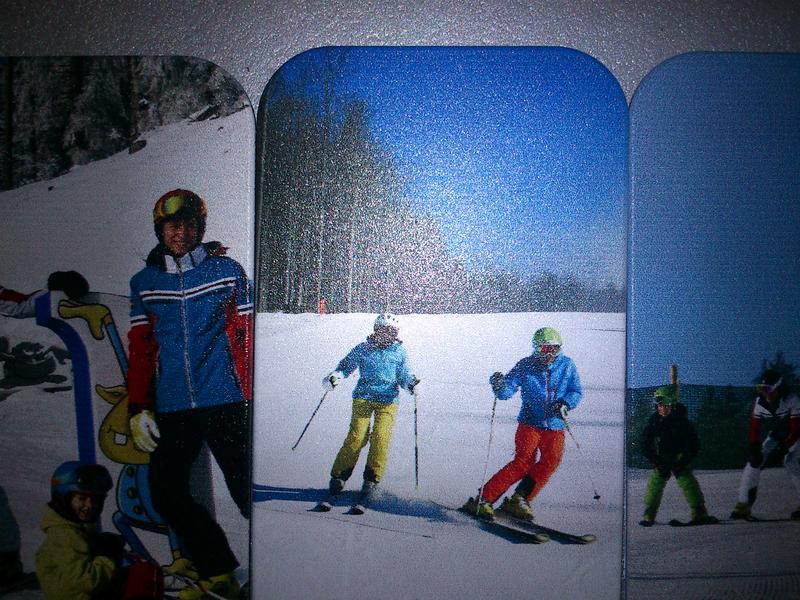

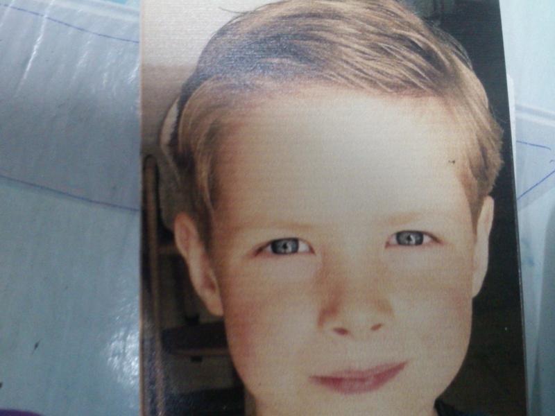

I keep getting lines on my print. I tried different resolutions and different settings , but without result. Did nozzle recovery too.
I print on ABS plastic( https://en.wikipedia.org/wiki/Acrylonitrile_butadiene_styrene) material and sometimes on other plastic materials such as PVC and others. I tried dot settings ( 3,2,1 ; 5,3,1 ) . No result. I use rasterlink pro 5 IP. Rip my images in eps. Color is LH- 100 CMYK. I tried other settings too. If someone have solution for this , let me know pls.

Looks like a banding issue to me. Something with the substrate advancement or something needs to be recalibrated. Basically the substrate is moving a little to far for the pass width. Re-calibrate. Not sure on your specific printer what the settings change would be.

I have some option called "MAPS 2" function. I tryed it before but no results. Also I have "checking ink landing displasement" option. I`ll try it today , and update . Thx for replys.

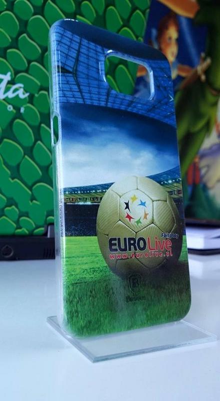

meritan

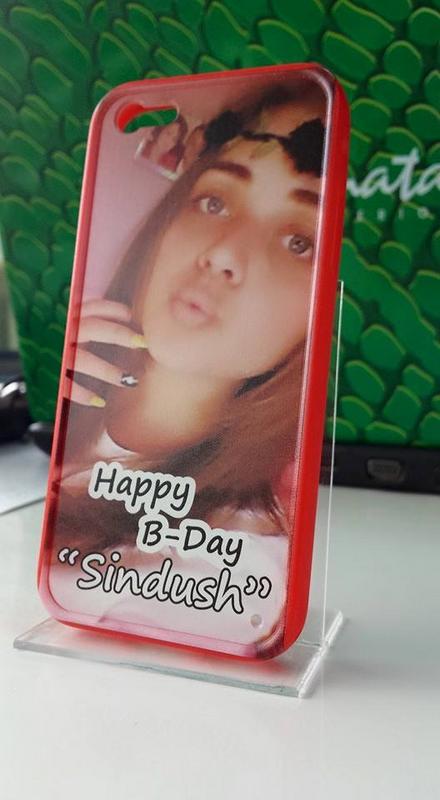

Case phone printed with UJF 3042 model 1 , 16 pass 1400 x 1200 dpi, eps, gap 1.5, glossy mode, (white printed first, CMYK next)
model 2 the same without glossy
I have the same problem if I print with 4 pass, and if you print log time, you need to check nozzle, and doing cleaning

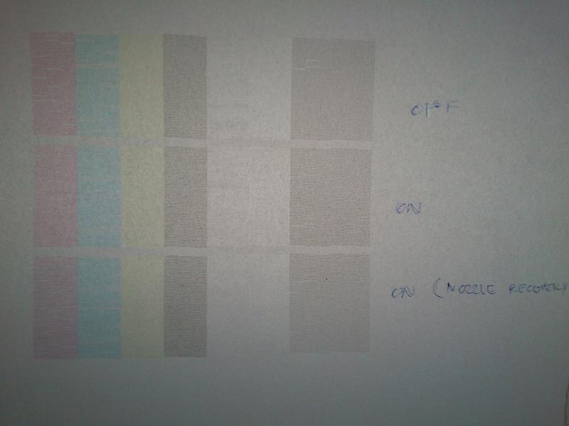

can you post a picture of a nozzle test?
Even if you are missing just one nozzle, it will give you this problem. :(

I know that my test is not perfect , but I think its satisfactorily.

A little hard to see but seems like cyan is affecting the most. I believe is a problem with those nozzles missing.
On the flat printer I operate, even with only 1 nozzle missing, I can see the banding, it really sucks.

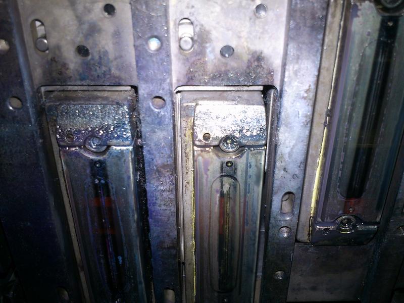

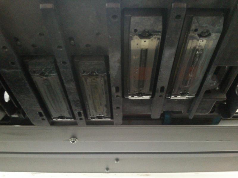

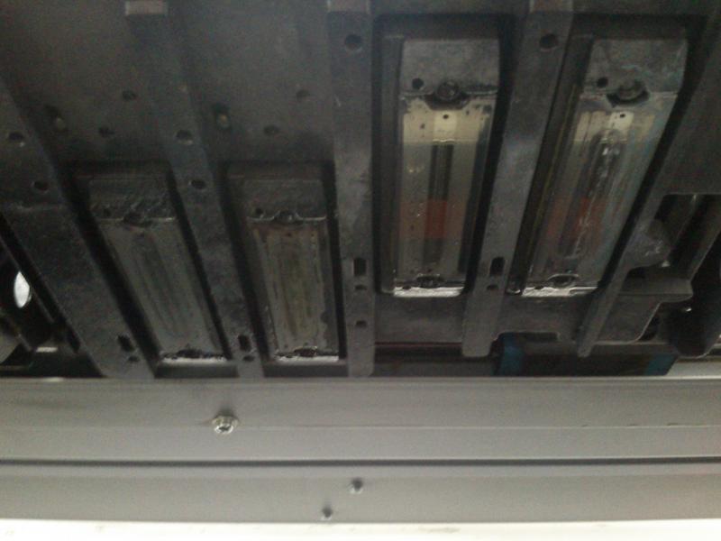

I washed heads with mimaki washing liquid ( f-200 , spc -0568) , and with cleaning swab(spc-0386) provided by service. I think I have clodged nozzles. I took picture of heads. How bad my heads look?
dvdcr
they look a little dirty, but sometimes that is just normal.
I would suggest to soak a lint free cloth and clean the heads with it very gently.
