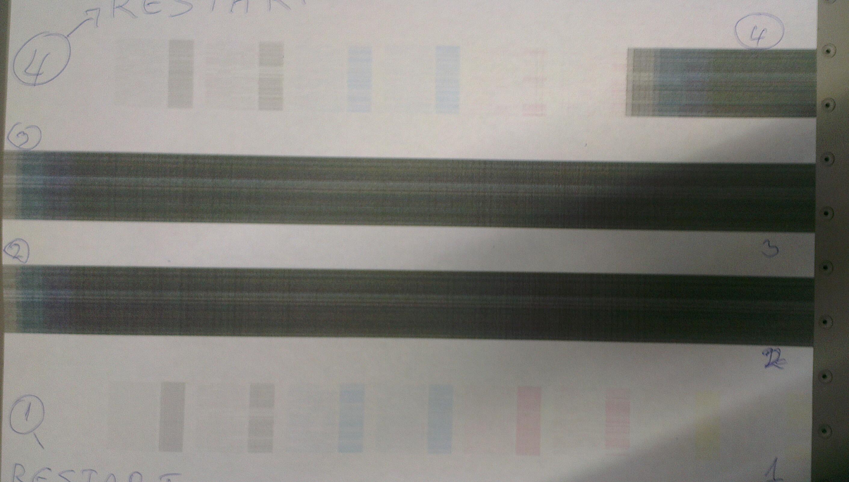

    I use DTG-printer with two heads
    Today I did four identical tests on the printer
    The picture shows how the printing changes for a few minutes. Is there any information what the problem is.
    Thanks in advance

    That's an electrical issue. Usually it is due to a short in the head cable, a short in the head, damaged CR"Trailing" cables or main board issues. Most of the time it is the head or head cables that are damaged and need to be replaced.

    Thank you for the answer. Yesterday switched places of cables white head with those for CMYK. White ink output with CMYK head and CMYK output with white head. I ran a test, expecting to print in white. The printer prints the same problem through the CMYK head. The printer does not take into account changing the wiring of the two heads.
    If the problem is in the cabel of the head this can be done by an engineer or I need to change the head as a whole
    Thanks in advance
    Greetings

    The problem is solved. For my joy it was in poorly installed cables on the board
