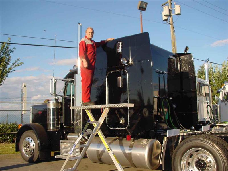

These are handy for trucks. The plank is long enough to get over cabins.

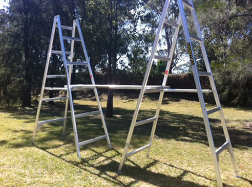

I don't see how this could work... once the ladders are spread far enough apart to get a tractor between them, and get the board up 7' or 8' in the air it seems like 13' would just barely reach the inside rungs. Does the board lock onto the runs or just sit on them?

That's just a pic I found online.
Our planks are 4 metres long and have rubber beads along them to stop slippage.
They're strong enough to hold two people.
They work great.

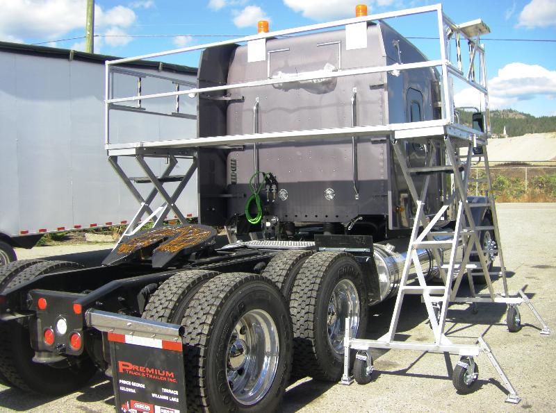

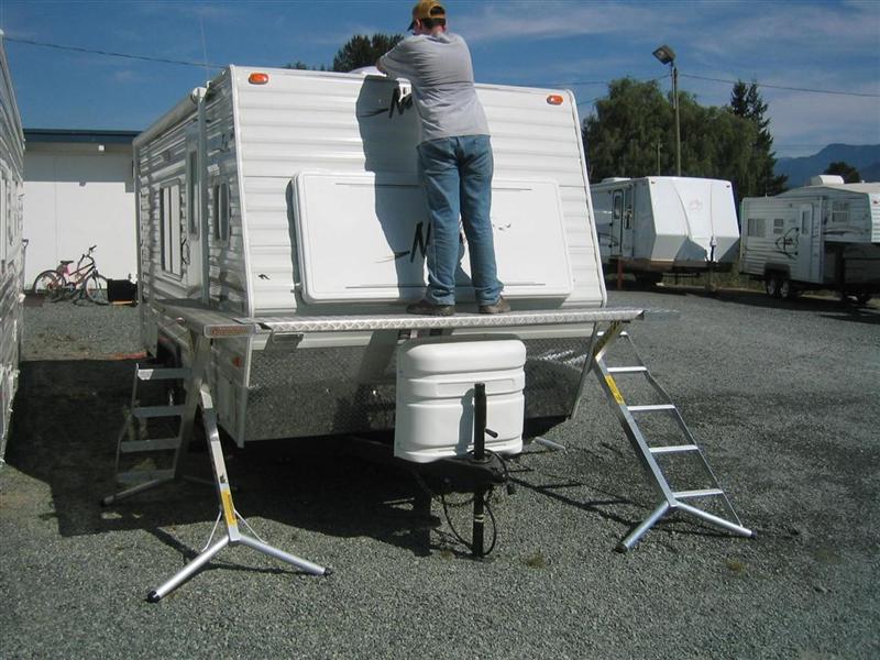

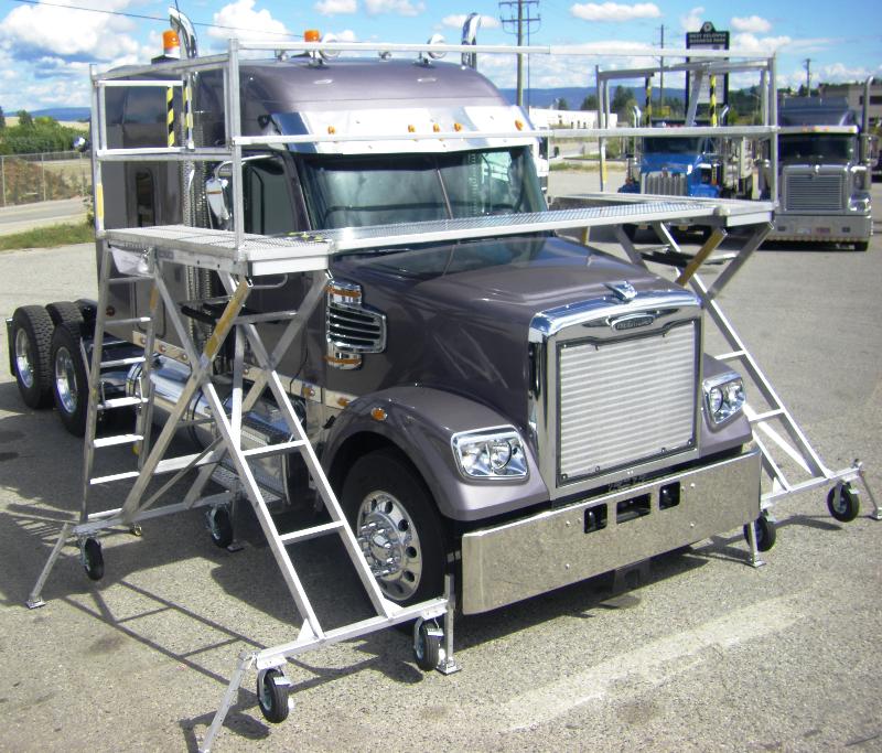

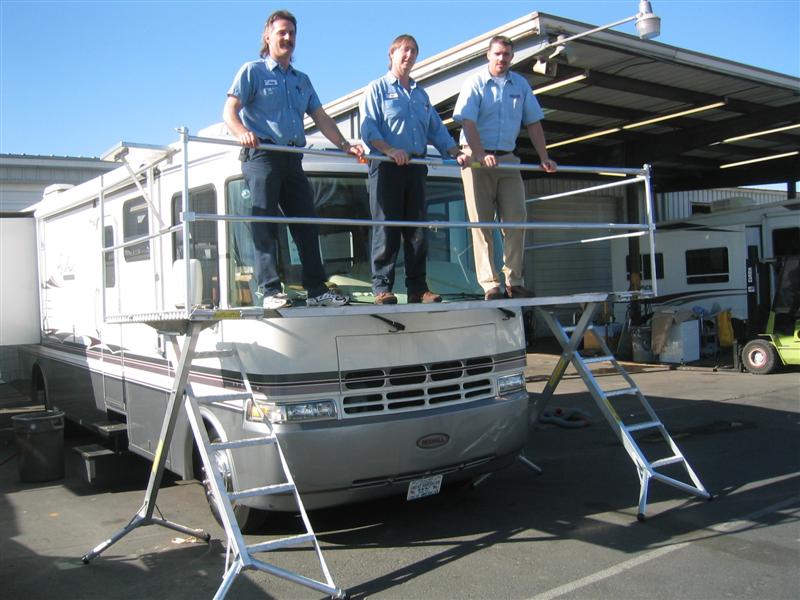

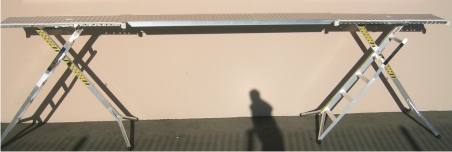

I work alone here so I have had to find ways to do it by myself. I've bought a set like the one pictured along with connecting plank (8ft). Works great, lightweight, portable, can be connected in-line to make a 16ft catwalk when striping the top of a Sprinter or in "C" to wrap-around the cab when applying graphics on Hi-Rise sleepers (where cab allow to stand-up right from your seat) There's a distributor in USA but I don't remember their name. I got 'em from a guy in Vancouver. From entry-level models to their "Cadillac" one on wheels, these scaffoldings worth every pennies.
