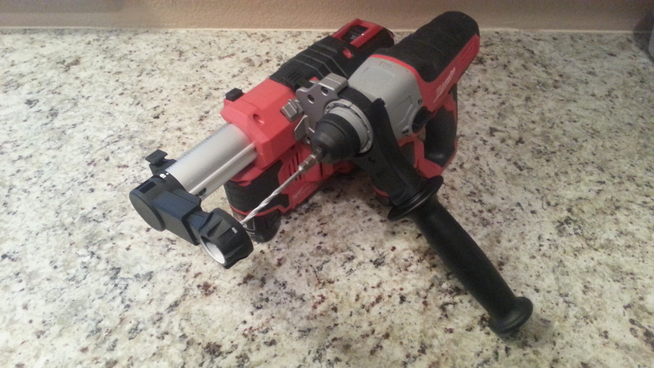

Milwaukee M12 SDS Plus rotary hammer - great for smaller 'delicate' jobs (faux stone, etc.):

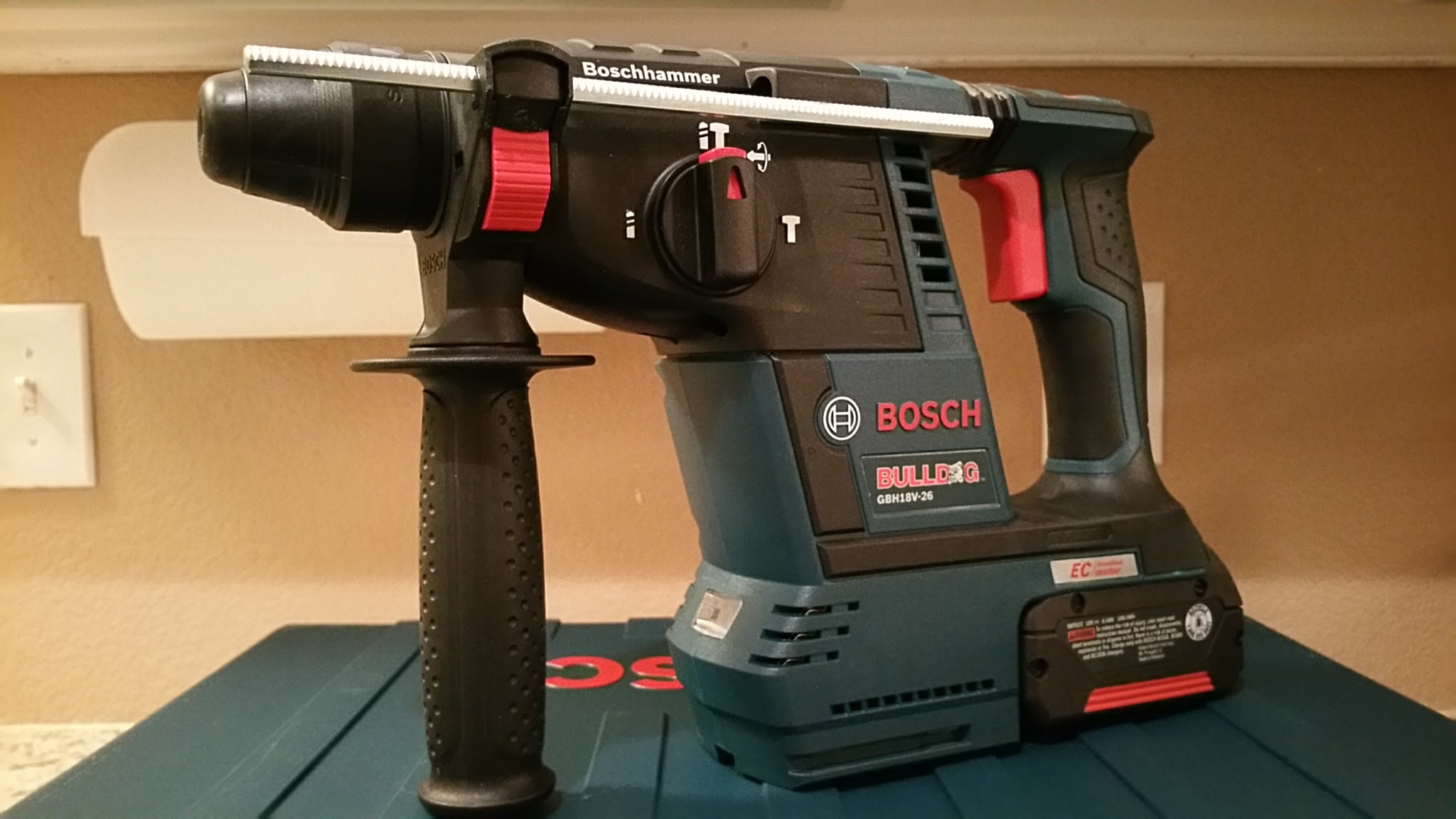

Bosch Bulldog GBH18V-26K SDS plus rotary hammer:

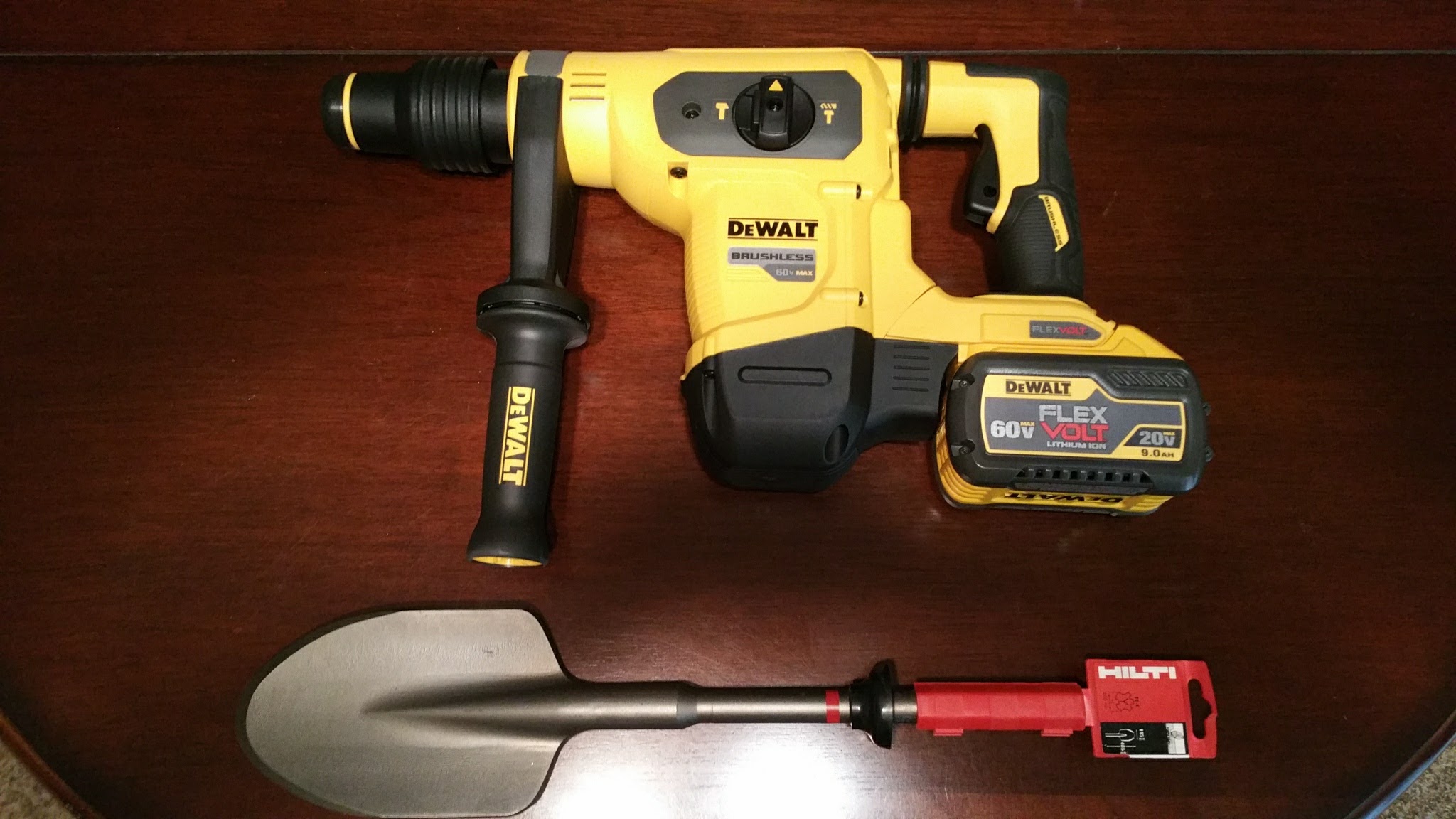

For the big tasks, core drilling, demo, digging, DeWalt DCH481 Flexvolt SDS Max:
