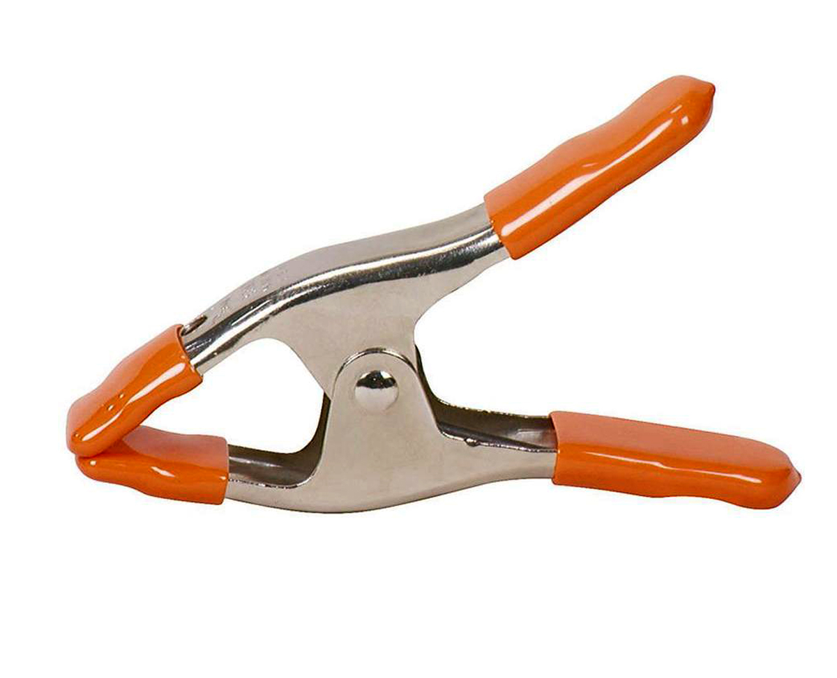

    With banners I always use the covers for the heating element. Without them the banners seem to stick and then bunch causing a head strike. I sometimes also put some of those clips you get from home depot at the edge of the media to hold help hold the media down until there is enough banner media weight towards the floor to pull it by gravity.
