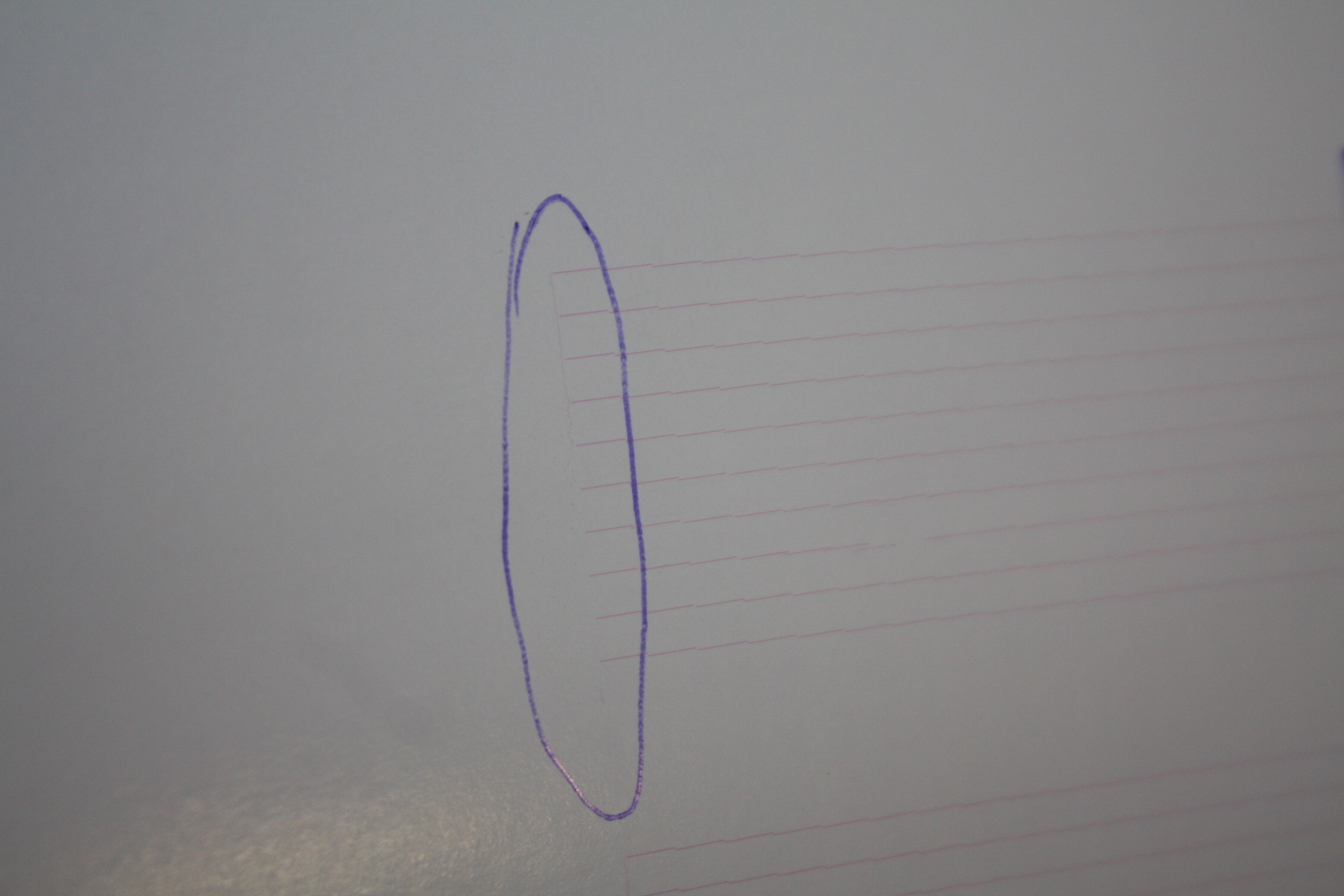

Hi boys, can you say what is wrong with my printhead ?
Right side down :/
Is printhead KO ? Or cable, or motherboard ?
Thank you.

That is usually just a result of missing nozzles/drop out. You might need to clean or replace the maintenance station and dampers. The older the head is the more likely it is just failing but usually missing nozzles are just caused by maintenance parts failing.
