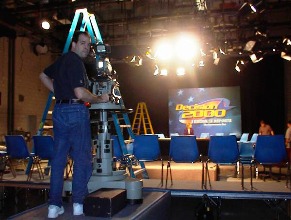

in the billboard world we have hurricane frames (the hurricane wind frame system), and in my shop we often make similar frames for various clients needs. The attached photo is an 8x10 flat built that way for a tv station years ago (and me hamming the camera). easily changeable with a new banner..
youre basically making a hollow framework that tensions the banner over it. with pole pockets on all four sides, and a bleed fo 6 inches, you can pull the fabric taught over the frame with ratchets straps and poles in the pole pockets.

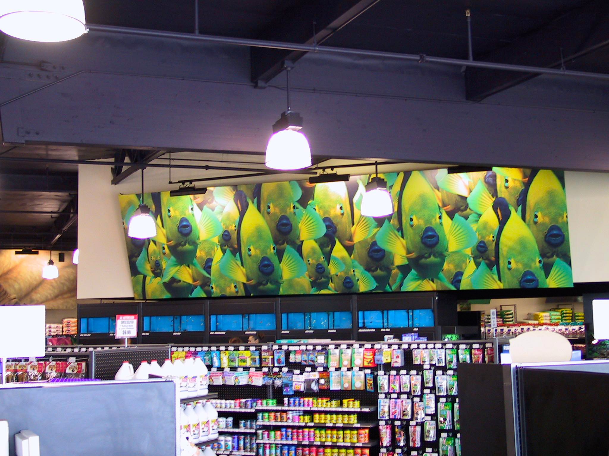

One more, an entire store of these frames at 6'x24' for a pet store. theyre lightweight aluminum .065" wall square tube with banner tensioned over face.
