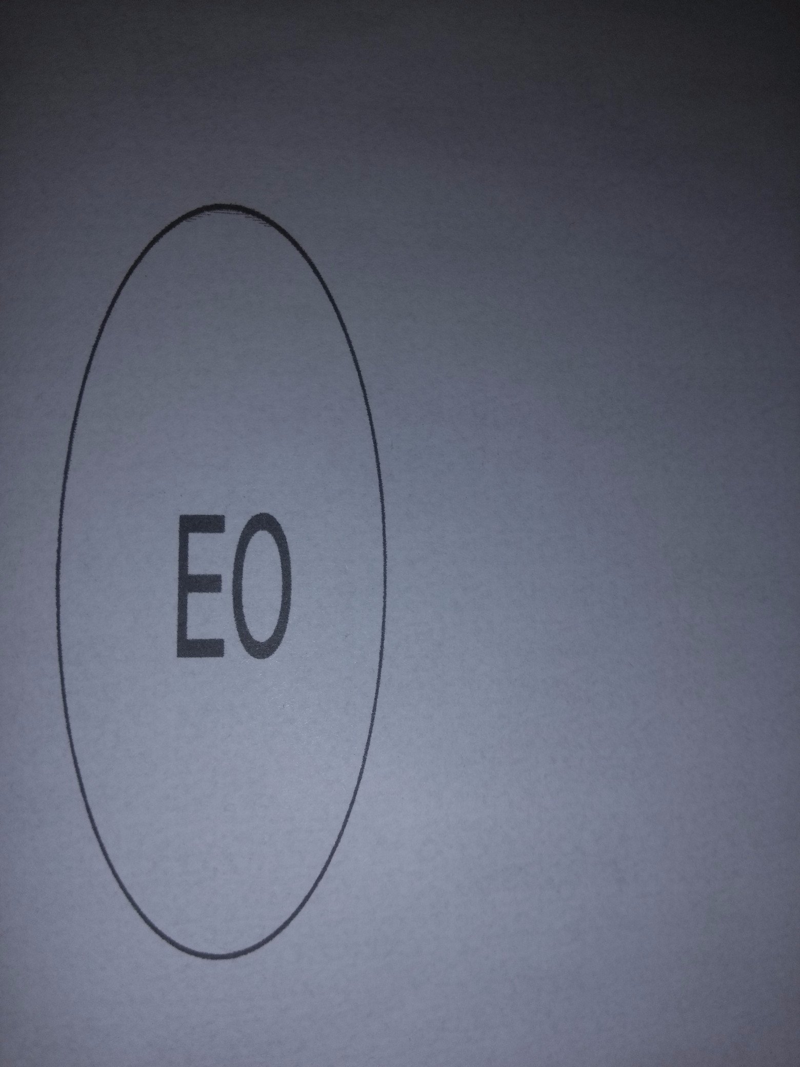

I did test print. But next problem is that the tray moves too fast.
As you see picture. The logo should be round, not oval.
It stretch the picture.
Can it be the fault of that value maxSteps and stepFactor is wrong?
Where are i can changed maxSteps and stepFactor?
