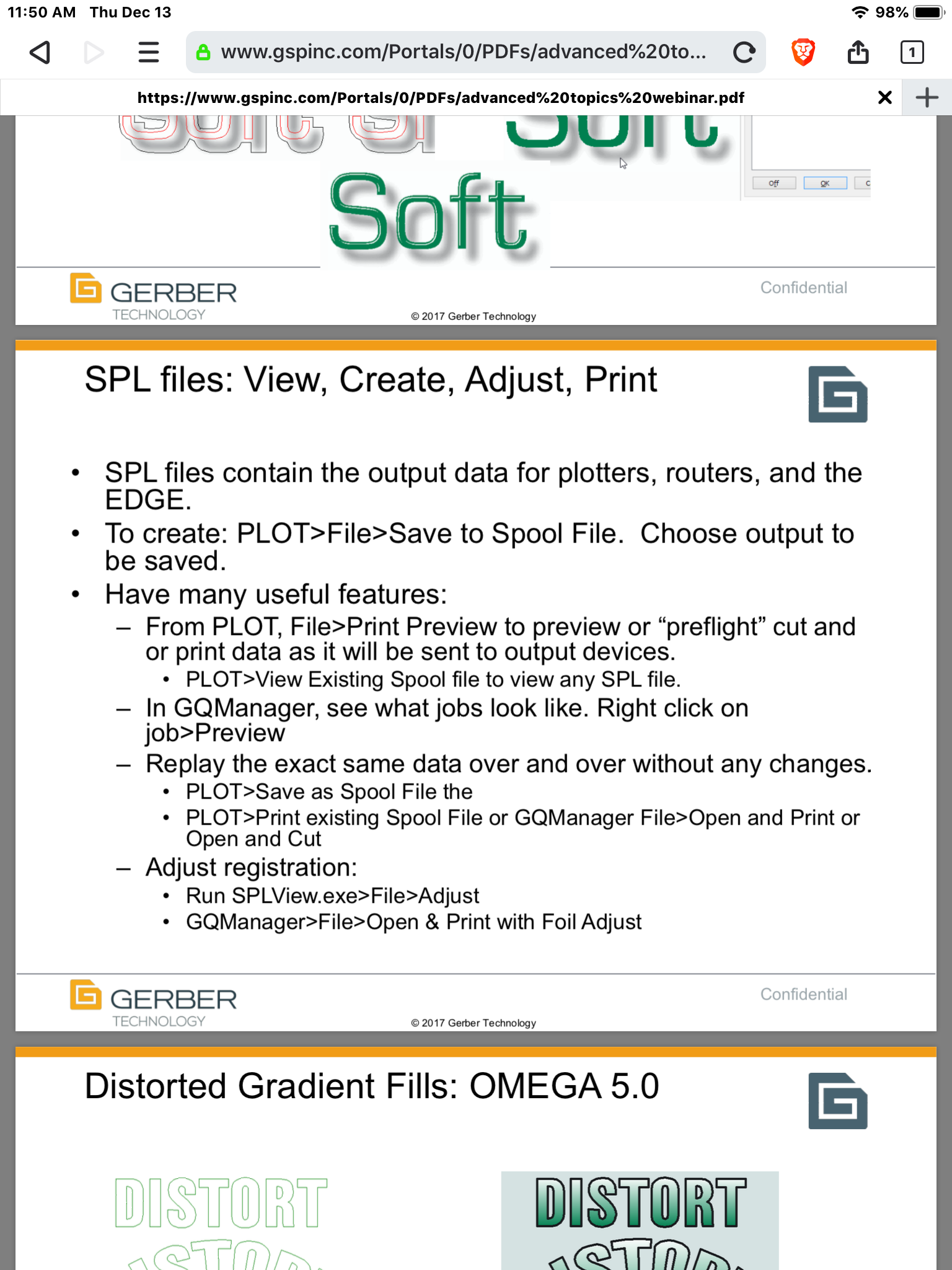

    Yes there is a way to calibrate the foil placement - check your help section in your software. it involves printing a small sample, and then it asks you which direction you would like to move the registration for each color.
    check under foil registration adjustment in your software manual. I have never used the feature though.

    I been messing around with this the last little while, all i can fin is under the print preview you can click on adjust, then you can print a pattern and adjust each color
    witch works well but you have to do it every time for every job with becomes a pain
