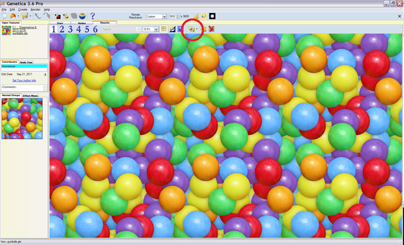

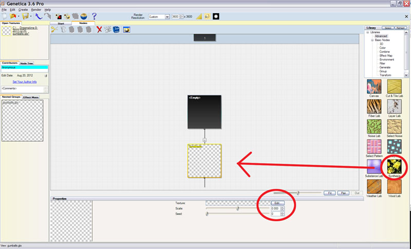

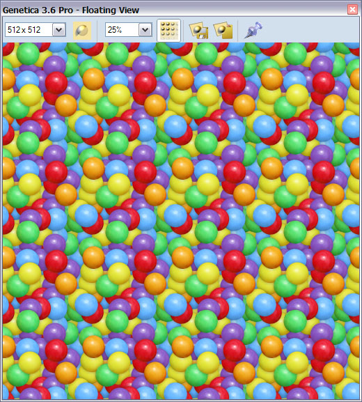

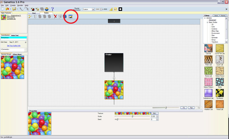

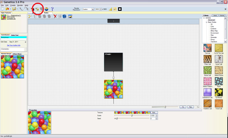

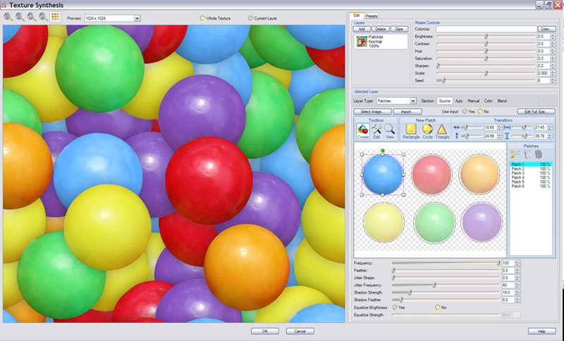

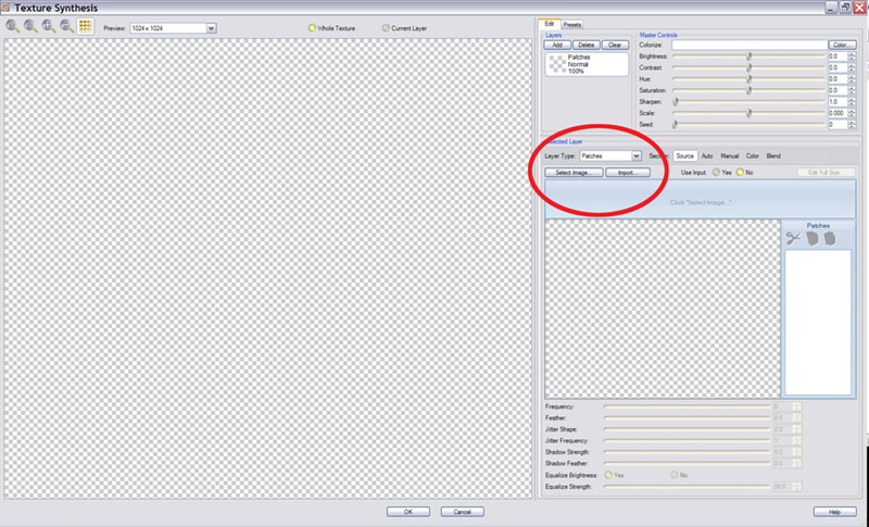

    You've gone astray somewhere. Try using single isolated images each set as a patch and let the software create your tiling for you.
    See images and ask specific questions.
    1. Start with blank synthesis node and click on edit.
    2. Click on import to bring in each individual image.
    3. Set selection for each patch image.
    4. Create floating view to fine tune automatic settings.
    5. Floating view.
    6. Click render.
    7. If satisfied with the tile, click export.
