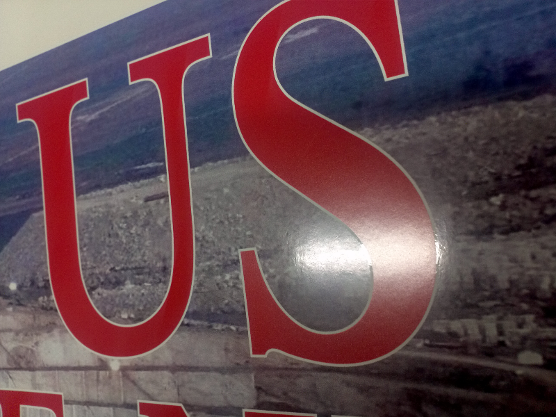

    For wrapping? And regular, everyday applications (calandered)?

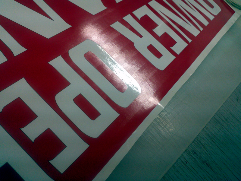

    I ask because. I'm using the 3000 profile. It has good colors. And nice (no green grays) but the 540x720 sucks... i have to print on 720x1080 to get good prints... here's a picture of the one with 540x720....and second will be 720x1080... printing on cjv30.

    I have used there wrapping film but not there print media. The wrap media is not bad alittle more tacky than i would like but it works.
    As for your prints you may need to use another profile sometimes if you are using canned profiles you can use a profile for a different material example we used to use a 3M IJ35 series profile for printing on Oracal 3640 it worked great.
    Alos I believe your printer is the same as mine I have a JV33 and the native resolution is 540X1080 try that and see what you get.
