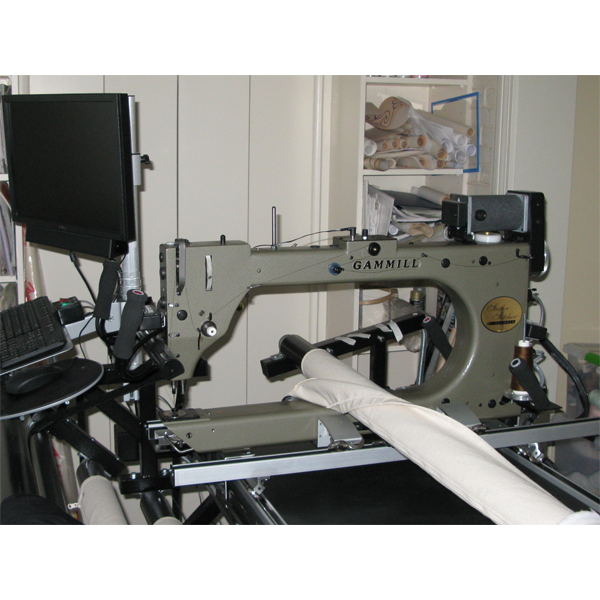

    What's that beast you got there?

    I think it's a BowFlex home gym.

    Statler Stitcher long arm with a 12' quilting table.
    That's the beast that we use for the quilts (I know, manly word like beast mentioned in the same sentence as quilts). What can I say, I like machines with needles.
