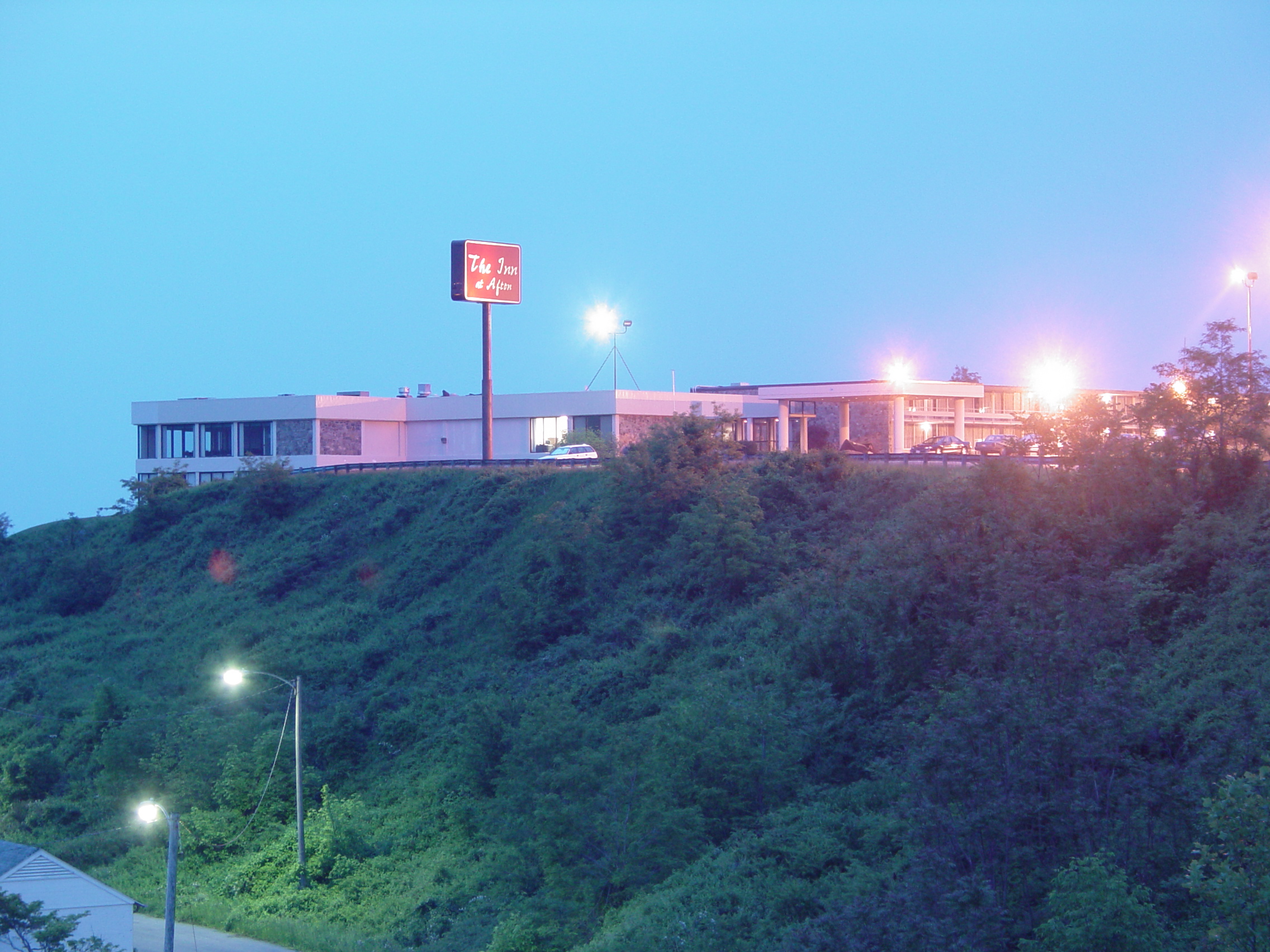

A customer wants two banners (single sided) on his pylon sign cabinet. I already told him this was a bad idea. He wants us to create a pillow case basically to go over the cabinet. It's about 14' Tall X 25' Length and sits 45' in the air.
I was going to lace the grommets together on all sides. However this is a weak point and will cause the grommets to rip out. I am thinking that adding a flat bar against the banner behind the grommets will give it reinforcement from ripping out. The retainer could help hold it as well.
Winds can get up to 60mph because it's in a valley region and way up on a mountain.

That looks like it could be a retro fit flex face, I don't see retainers....
If it does have retainers I would remove them, use tap screws every foot or so & replace the retainers.

That is an old photo from a couple years ago of the old banners. They ripped apart after two years. This sign is roughly 52 years old. So it's in poor shape. There are clips in it, which I don't know how to use, however they are damaged and I wouldn't trust using them. I am using a translucent banner, so that it can illuminate, They would never be able to get inside the access panel with a pillow case style. They are using halogens inside.

Sorry Ams, but you have to have some facts wrong... that's clearly a flex face, not a banner & if it has clips, then that backs up the fact that it was a flex face.
Also, unless it's a brand new product, that I have never heard of, there is no such thing as a translucent banner, just banners that are not block out.

That cabinet must have been changed over to flex faces because I don’t think they had them in 1966 if it’s 52 years old. Retrofit it to present day flex face hardware if it is not rotted out to bad. Try to sell them a new sign cabinet with new faces.

The clips in this sign don't match those in the videos. It's done a different way by inserting a tube through the clip, nothing actually stops it from coming out, it's just pressure holding it. Which is why I don't feel comfortable using them. Average winds are 20 - 25 mph daily, but storm gusts are in the 60 range. This morning when I woke up, I believe I discovered how to do it, I am going to put gorilla tape on both sides of the banner edges, then screw flat bar over it behind the grommets and then lace the grommets together. This way the gorilla tape would reinforce the banner and help prevent any ripping. Then combined with the flatbar keeping it firmly pressured into the cabinet and with no chance of the grommets slipping or breaking the 1/8" cabling (340lb load). Should be good. If it rips, it's going to rip the middle of the banner face.
