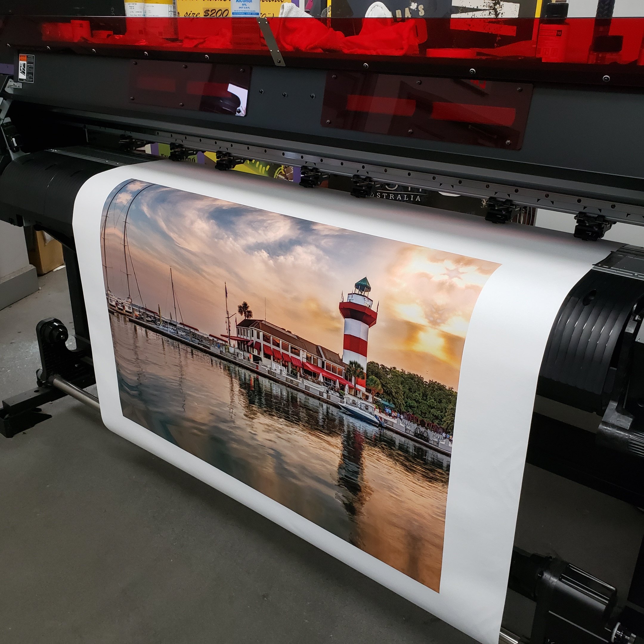

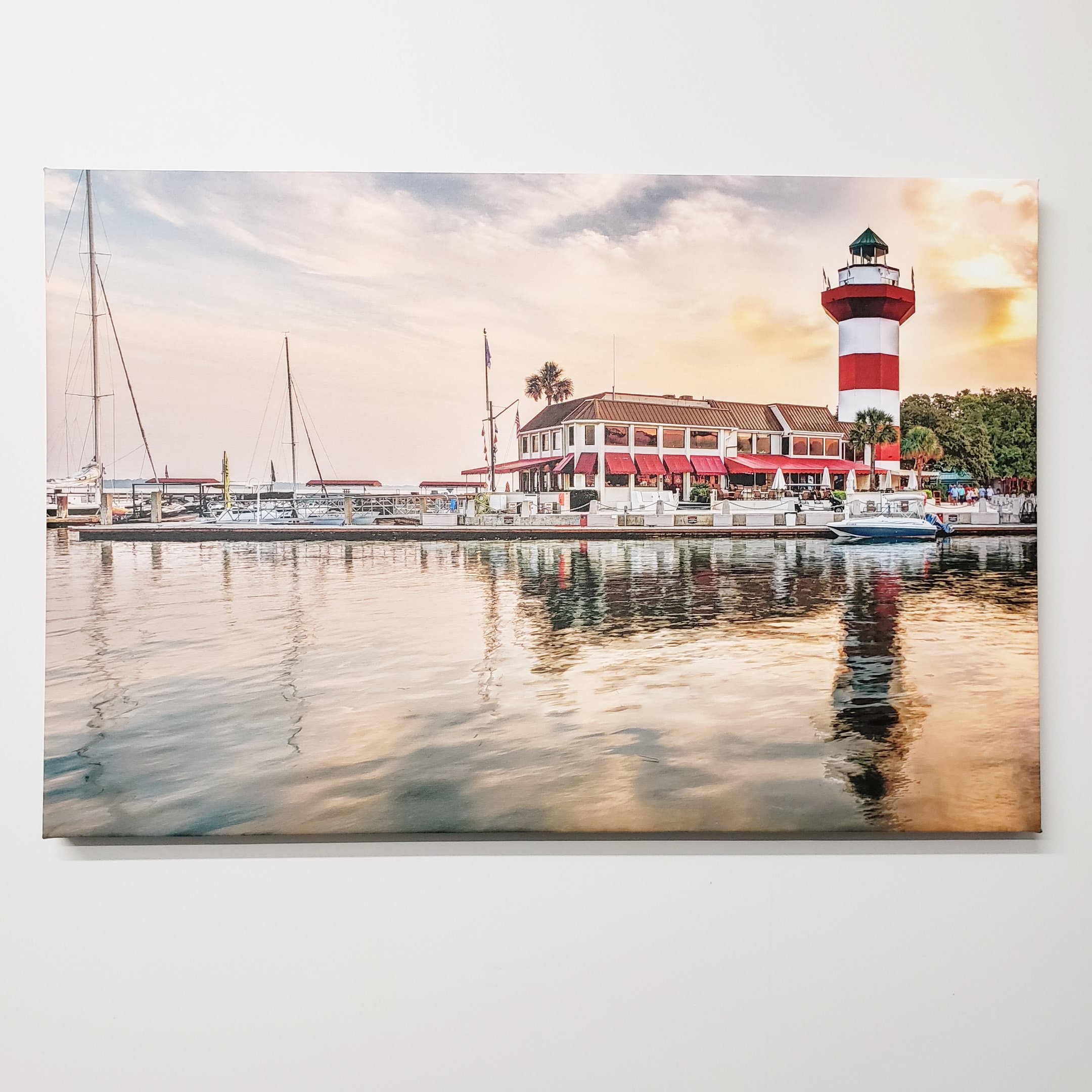

I have an old IPF8400 pigment inkjet printer that I print canvas on.
I am using Epson Exhibition Canvas Matte Media and I vinyl laminate it with a vacuum heat press.
Cons are:
- Two steps to print and laminate the canvas
- It's a little harder to stretch by hand, and sometime it loosens up over time
- Corners usually have bumps that stick out a bit, from the thickness of the medium
I would like to switch to a medium that does not need to be laminated or sprayed, does not crack during stretching, is not too thin and does not look cheap.
What would you recommend?
Thanks
- John

AFAIK you will need to at least go to mild-solvent or latex if you don't want to over laminate. I use Latex for our canvas printing.
It's not the media, but the method.
You aren't really setup to compete with the many printers which do this sort of thing.

I have had great luck with Sihl material for aqueous, but the coating it has can be chalky and prone to chipping if kept in a humid environment for a long time. We ran it in an older Epson Stylus Pro 9900 and the colors were amazing. Longevity, not so much. The Epson stuff was good too, but I never laminated it. Didn't know laminating canvas was a thing, but I work more on the tech side, so I might be pretty dumb in that area.
If I remember right, the ImagePrograph (or whatever awful spelling Canon used) is a thermal dye ink printer, not a pigment printer, so colors might not be terribly great.
Keep the printer you have for your aqueous needs and get a 54" something. If you go with 44" you'll be sorry the first time someone asks you for a 4' x 8' banner. Our roland is very good for banners and we don't bother wasting laminate on a banner. Banners are only meant to be used for a year or two. Anyone who wants it to last longer should invest in a permanent sign, which on a 54" you could also do.
