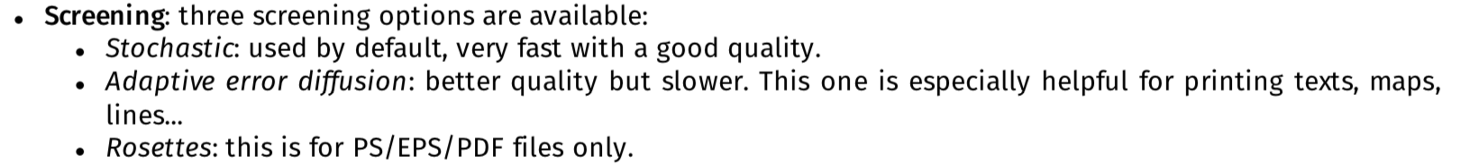

    I've never noticed a difference in output whether I used Stochastic or Adaptive Error Diffusion, so I just stick with Adaptive Error Diffusion (Using Caldera).
    I generally get better results switching rendering intent from Relative Colorimetric to Perceptual when gradients aren't printing well. Quality is more related to profiling/print mode/passes/inks/etc than dithering type.
