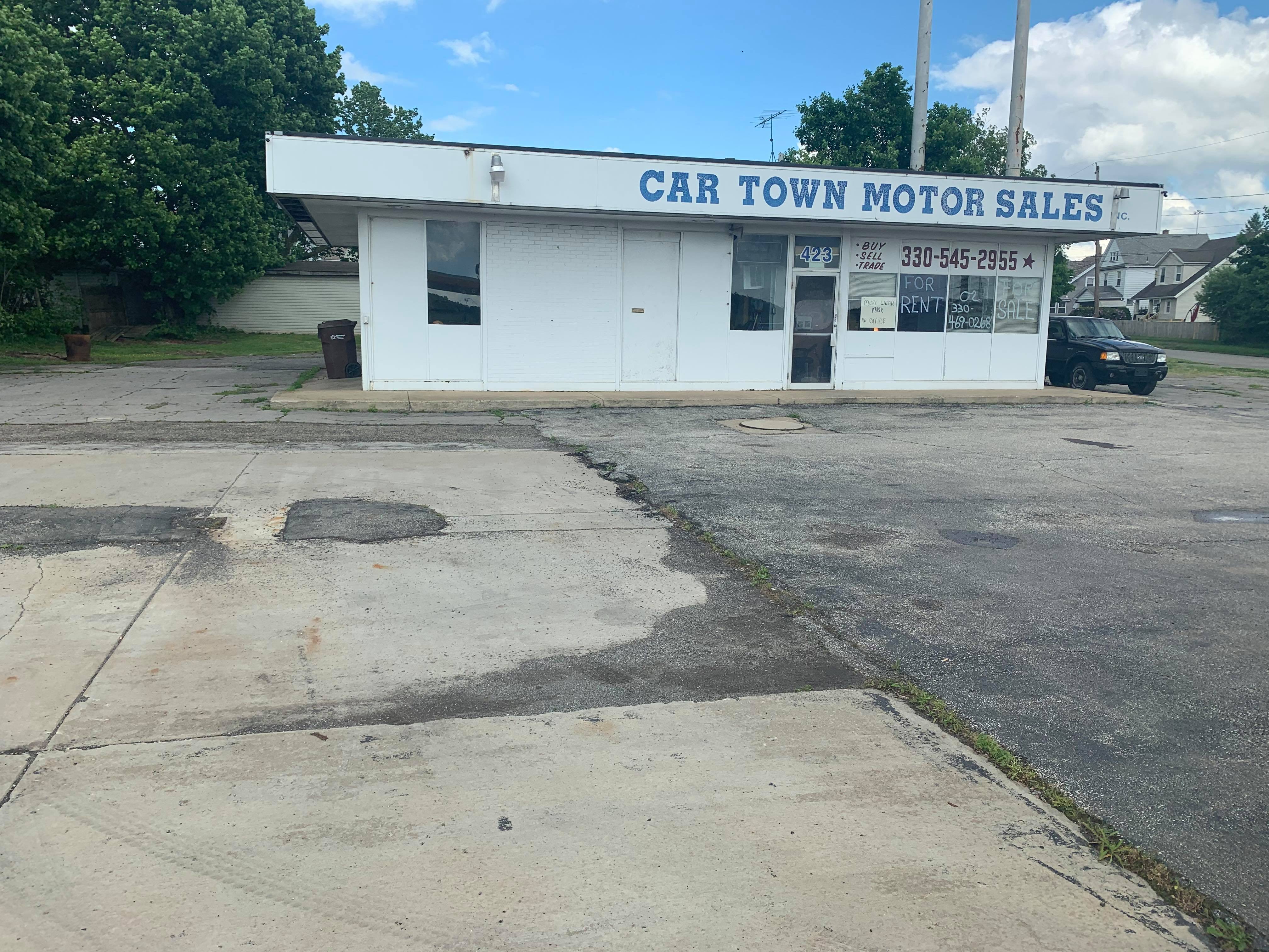

Just looking for opinions, what would you replace that old painted lettering with?

You could put an illuminated sign box on the parapet. It could go up over the roof for extra impact.

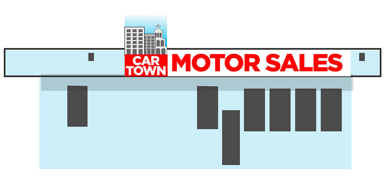

We all know used car lots aint gonna spend money, nonetheless, I would do some .040 aluminum coverup and reverse the company name on it so it stands out. In a perfect world they would redo the whole building and make it look nice but you didnt indicated thats what they were doing. I doubt very seriously they would go for a lighted sign, see attached layout

Yea, my suggestion would be to reskin the whole fascia with ACM in a nice color and letter on top of that. Wouldn't cost all that much and would be a huge improvement

hey that’s for the info and the layout, definitely going to go in that direction

If the customer had the budget for it, lighted channel letters on a raceway would be the most effective choice. Non lighted, fabricated metal or plastic letters (whether you make them yourself or order them from an outfit like Gemini or ARK Ramos) would also be effective.
Sign cabinets with flat acrylic or pan-formed Lexan faces are (usually) less expensive than channel letters. But the lettering, logos, etc all end up having to be smaller to fit within the confines of the sign cabinet. You have to take into account the retainers and then have some "breathing space" in the sign face for the design. Channel letters don't have those restrictions. And they fit into a wide variety of building architecture.

I agree, if you do any more than this you're wasting your time. Id even tell the guy a lighted sign was a waste of his money and to upgrade later if things worked out. Look at the building. It’ll be a buy here pay here and likely gone in 6 months.

You know it is not going to be CarTown again. There are for sale and for rent signs all over it. The guys just looking for ideas on what to do for the new guy coming in. No permit for over the roof line sign or pulling someone off the street to paint a sign. Or sign letters or cabinet which are all good ideas. Maybe a good place for and old fashion A&W burger place with girls on roller skates bringing the food to your car.

The guy who rented the property is planning on putting a produce and plants shop there. The sign is going to say “Valley Produce & Plants”. Just wanted to get some opinions so I could have a few different ideas to throw his way.
