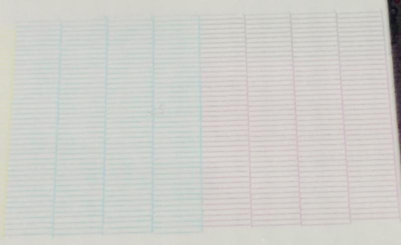

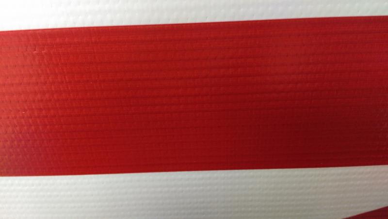

What is causing black to get into my magenta? It is getting into my prints. I've cleaned the head and it is still there. Please help me.
dwarrior
Update: I just cleaned the printer head and noticed a lot of ink on it and on the bottom plate if that will help. I am hoping I will not have to replace the print head.
Solventinkjet
DIY Printer Fixing Guide
Your cap top, tubes or pump may be clogged causing the ink to stay too long in the cap top and sticking to the bottom of the head. After running a cleaning cycle, take a look at the cap top. Is there ink pooled up in it?
