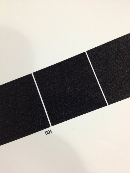

    Well, All other colors seem to print alright with exception of dark reds but black keeps getting these lines.
    I wouldn't say it was banding but it may be a slight case beings there is lines in it. It's more of a grain look to me.
    I am printing on gloss oracal 3165ra using the oracal profile for that straight out of the box, all the "come with" VW profiles, tried changing head speed, heat, bi and uni direction, max impact, us prepress, sign&display and still cannot get a nice non grainy black. The numbers in the photos are 80/80/80/100, 0/0/0/100 and 100/100/100/100.
    I was suggested using the 3751 profile as it lays down more ink but the same results.
    Using versaworks on a sp-300i with OEM inks. The machine was just cleaned today.
    Any tips?

    Run a nozzle check to see how the black is firing.
    Hard to tell from your pic if the CMYK changes are doing anything.
    I get nice rich black with no drama using RGB 0,0,0 black that works out to
    C75,M68,Y67,K90 on gloss materials.
    wayne k

    also try bk21a thats what we use and it looks like black cut vinyl

    I had the exact issue last week on my roland, ended up changing the black to 30/30/30/100 and ran on the sign&display preset. Also you may want to go to general formulations website, i've found their Automark profile to be awesome for 99% of my vinyl printing
    http://generalformulations.com/230.asp

    Oh lol my mimaki is the same, 540 and lower gives bad results, also using cmyk black gives me problems

    looks like too much ink. id say its a profile problem.

    Try the 3651 profile and see if it's any better. I never liked the 3165ra profile.
    Could also be bad material...
