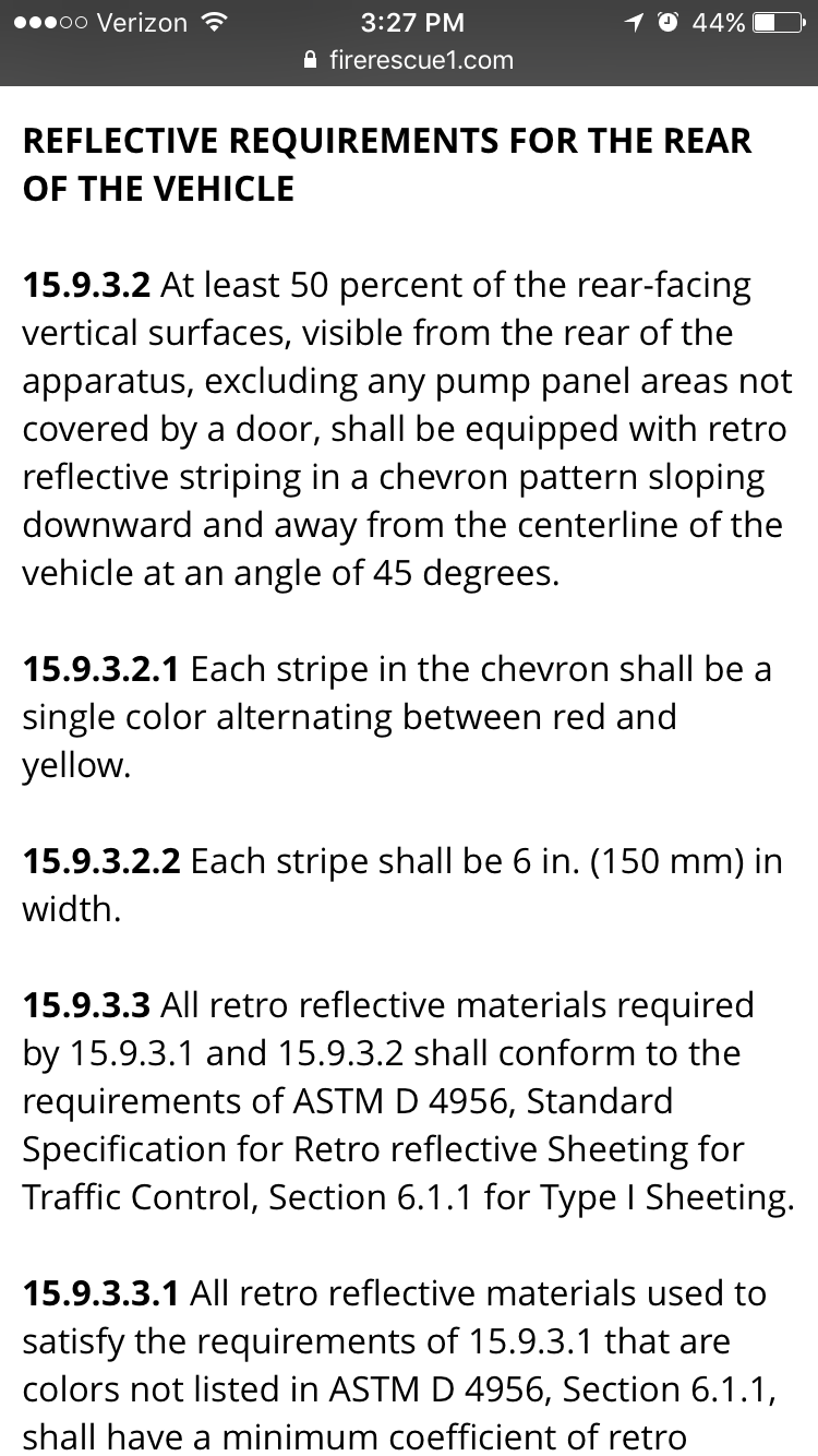

The NFPA clearly states the colors red and yellow for use on the rear of a fire apparatus.
So it looks like the black and white is not even an option.
NFPA sets guidelines for fire apparatus, but they are not law. Many departments choose to take an exception to NFPA guidelines for various reasons. There are still plenty of trucks being made with different color chevrons or none at all. However, since they are nationally accepted guidelines, if XYZ fire department knowingly takes an exception and puts pink and purple chevrons on the back of their truck, and a car smashes into it 3 years later... a good lawyer could argue the fact that the truck wasn't compliant according to national standards and that is why their client crashed into it. Its not likely, but it could happen. This is why its best to stick to NFPA standards if at all possible.
CreatedDesigns
I have never heard of the NFPA as being "guidelines" these requirements are in the book for a reason and most fire commissions in each state will refer back to the NFPA. You don't just pick and choose what you want and don't want.
The current year books are usually not enforced for a year or two.
It's up to the OP to contact the Texas fire commission and verify current requirements.
dgerb
NFPA is a codes and standards body. They do not make laws. Standards become requirements by local laws and and pressure from the torts system. So you as a community do pick and choose which ones to use. The local legislation can choose which standards to adopt. Picture Colorado not adopting hurricane building codes. So they are guidelines until adopted into law. Or if you are hung up on the "guidelines" part, read the other part of NFPA! The pedantics will appreciate "voluntary consensus standards." I would call that a guideline. The value of Standards Development Organizations.
