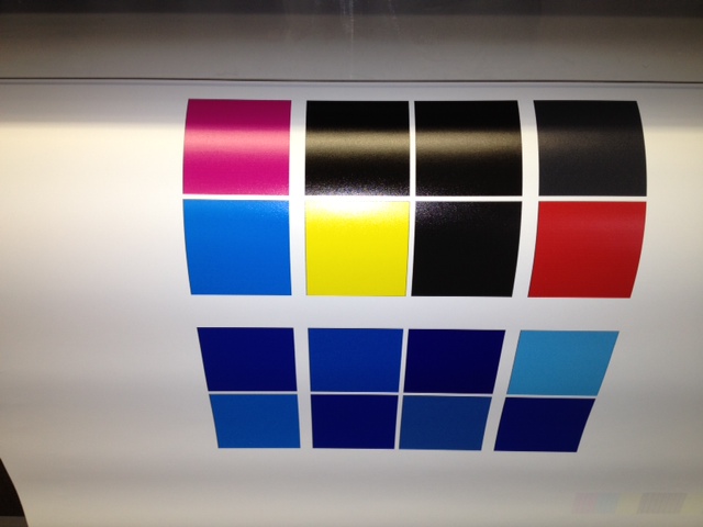

    Hi.
    Any pointers would be great.
    Blue is printing green on the JV33.
    Maybe a new captop?
    Anyone care to chime in would be great.
    Thanks
  2. 4R Graphics
    4R Graphics Active Member
    724
    Jan 28, 2008
    Are you running 4 color mode? if so are both cyans printing green if both are printing green sounds like a possible rip/electrical problem.
    If only one of the cyans are printing green then I would say either A. the dampner manifold(the black plastic top) is cracked or from experience the channel divider inside the head is broke and allowing the cyan and yellow inks to mix in the head.
    I blew out the seal between yellow and cyan once with a syringe trying to flush head manually to clear up some difflections in yellow.
    Other than head bad, manifold bad, or something electrically telling head to fire both yellow and cyan not sure.
    Post a pic of your nozzle check and a print so we can get a better idea.

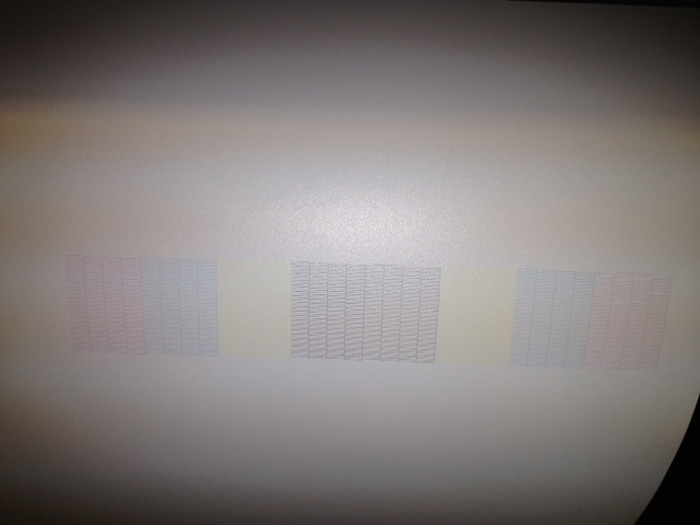

    Got it back.
    Pulled the ink through the tubes that connect the dampers with a syringe.
    99% of all nozzles are firing as well(pic is a little blurred sorry).
    Thanks Guys!
