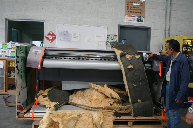

    Hello everyone,
    I´ve been a constant reader of posts from this forum, and I´ve found a lot of information that has helped me a lot.
    Long story short, just bought a jv3 160s on ebay about one month ago, listed as printing condition, when it arrived it was totally destroyed.
    I´ll be posting pictures of how I received the machine and the procedures I´ve been making to hopefully make it run again. (Today it´s still not running)
    If at least 1 person finds this post useful, I´ve returned a little part from all the knowledge I´ve gained in Signs101.
    Thanks you all.

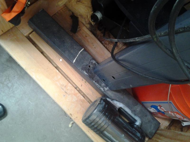

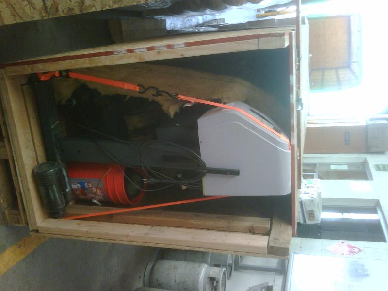

    On arrival
    Some more pictures of the tech checking the machine in the freight company.

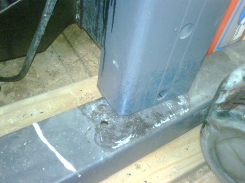

    Broken jv3 160s leg
    Broken leg

    o wow. love how they just simply strapped (more like CRUSHED) it down!
    also, "padding" shown has no real use whatsoever, except most likely filling the internals with loads of debris.

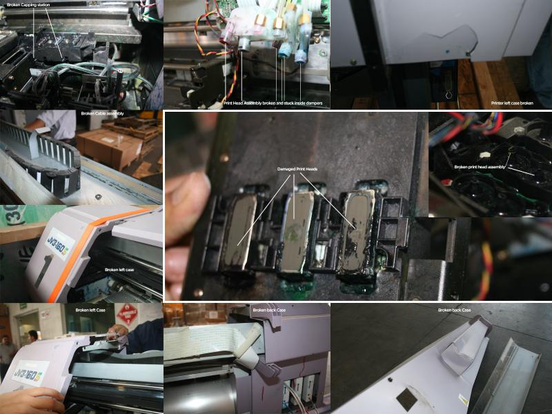

    best of luck on the restoral. hope you got a great deal on it, since at the very least you're looking at qty3-$800 printheads, the manifolds (black tips) will come with em, and you may as well get new dampers (ink filled white/clear pieces that attach to printheads) while you're at it for like <$30each.
    noted, i wouldn't worry much about the casing or the legs. they're really just a shell to protect the circuitry and moving parts contained within.

    Good grief, they tried to ship it without taking it off the stand???!!!!
    Looks like someone woke up that morning and took a whole handful of stupid pills.

  10. SightLine
    SightLine Very Active Member
    Ouch!! Shipping it on the stand is actually okay (not ideal but I've seen them shipped on the stand more often than not just fine). However the yellow shipping bars are missing which are REQUIRED for strapping the machine down properly. They bolt underneath each end of the main unit. Strapping it down over the machine is NOT okay, I've seen them damaged due to this before. The damage "mostly" appears cosmetic though but as is, it is only worth about $500 to $1000 at best due to the sheer amount of work it needs. My biggest worry and what would be fatal irreparable damage is if the carriage is bent. In the attached that could just be glare but it almost looks as though it were strapped over the middle of the carriage. If it was and that is bent, the printer carriage is junk and the entire machine is scrap parts only. You would need a near complete donor chassis, plus of course the expensive bits like the print heads. Even as it is, in my opinion it is hardly worth trying to fix. The JV3 is 10 year old technology, tougher to maintain, much more difficult to align, slower, etc than any of the newer generation machines. They do not have USB, only wretchedly slow parallel or firewire and the firewire card (while a good fast connection) on the JV3 machines is very well known for failing over time with IF20/IF21 errors. Personally, I'd be junking the chassis and parting it out for the boards, power supply, etc.
