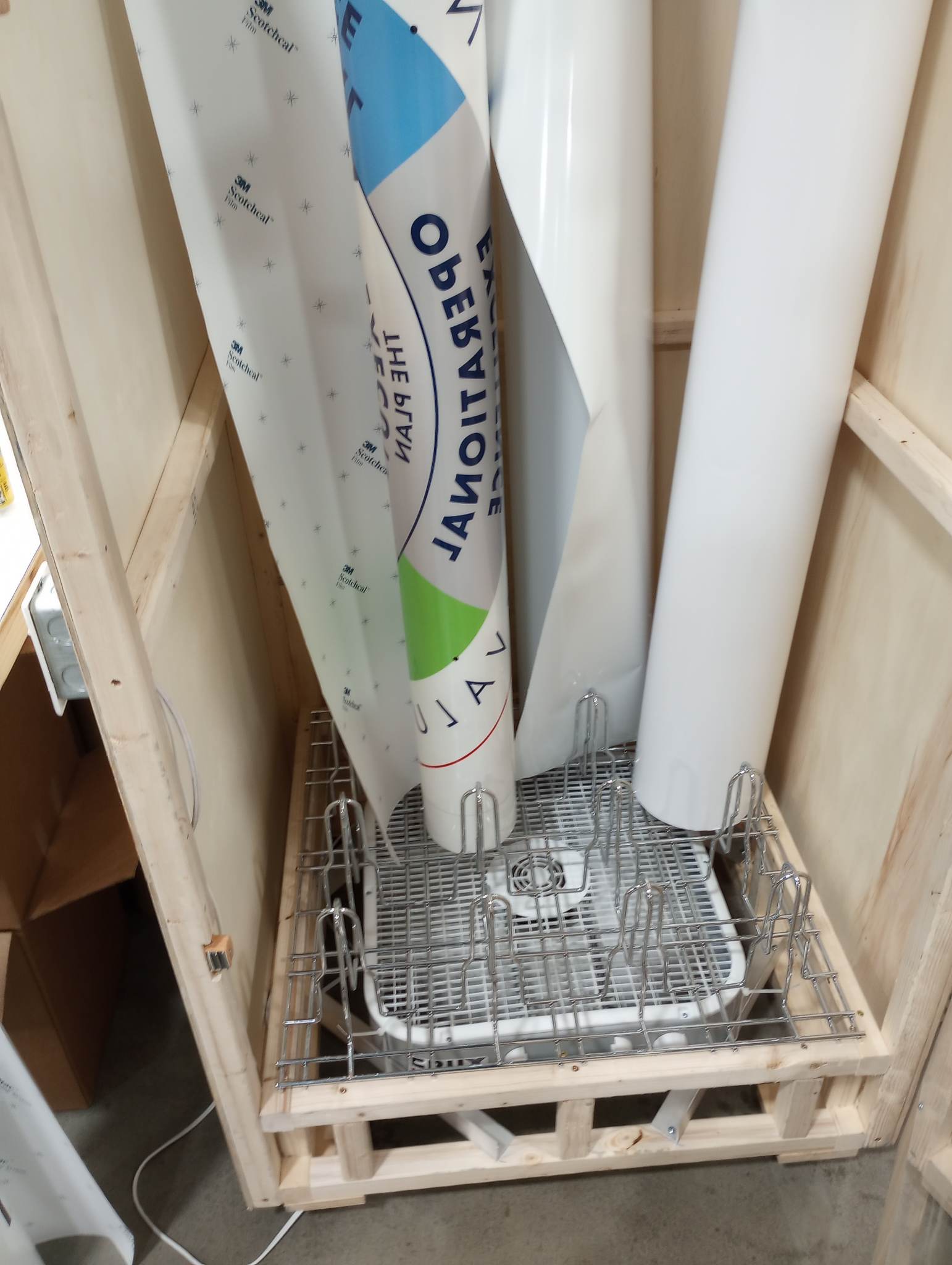

Not to sidetrack this thread, and PM me if you prefer, but do you mind sharing your offgassing cabinet pics? Need to rebuild ours and looking for ideas. Thanks.

Still using our cabinets here, one of the box fans died at some point last year ($15 replacement) but otherwise no issues or ideas for improvement.
Thanks for that! I forgot about that thread. Bookmarked for later when I have time to build a new and improved version of what we have now.
