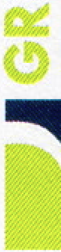

    However, when I print, the black prints fine. Every other color prints like it's using a halftone pattern. For example, the lime green I printed, has the halftone pattern in it and the dots are actually a dark blue dots. The gray has no added dot colors, but it does have the halftone pattern, it's just white dots (no ink). The dark blue I printed appears to have black dots in a halftone pattern.

    Here's what it's doing. Sorry for the poor image, but I had to blow up a lower quality scan to get it to this size.

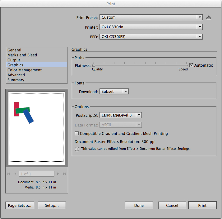

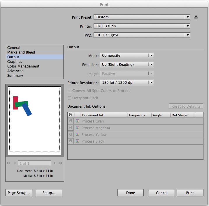

    Does your print command look like this?
    Your problem "MAY BE" in the original set up of the print mode in Illustrator.
    You should demand that the OKIDATA support people walk you through the set up S L O W L Y! and double check every setting before agreeing to keep the printed. Otherwise bundle it up and return it.

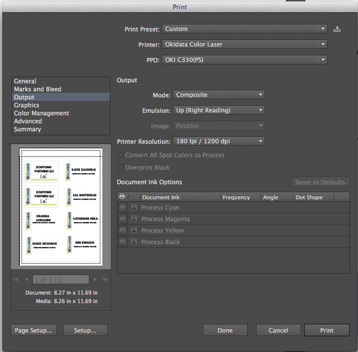

    Thanks for the replies. I saved as a PDF and printed it. Same thing. I saved as a TIF and printed from Photoshop, same thing.
    It seems to print the test print from the printer beautifully. No dots, not nothing, smooth as silk.
    I even thought it might be a problem with CS6, so I went back to CS5 and tried that and got a slightly different color, but same pattern.
    It's just an Oki C330. Nothing amazing. This has GOT to be something simple I'm missing. I do a fair amount of dye sublimation work and I've never had this issue on the dye sub. I'm using the same type settings that I get great prints from using that process.
    Here's what I see on that screen you showed.....

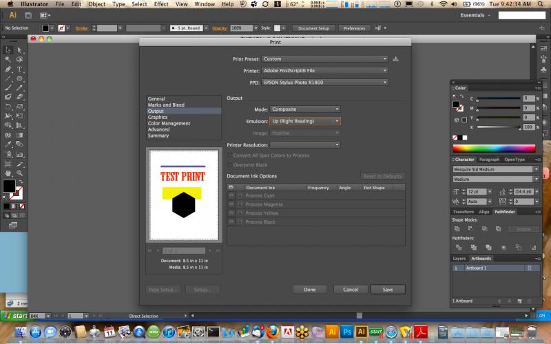

    Okay... hooked the printer up and ran a test... I'm getting solid colours. Do you mind sending me your file to try? Not that it makes a difference.... but I'm running Illustrator CS6 on a Mac. Send your file to me (tim@kkcalgary.com), and I'll try printing your file and see what I get. Here's the print dialogue I'm using (as compared to yours). Wondering if it might be a setting in another window (graphics, color management, etc...)??

    Thanks Tim, file has been sent. I don't see anything in your screen shots I haven't tried. I'll try that combination though, and see if it helps.

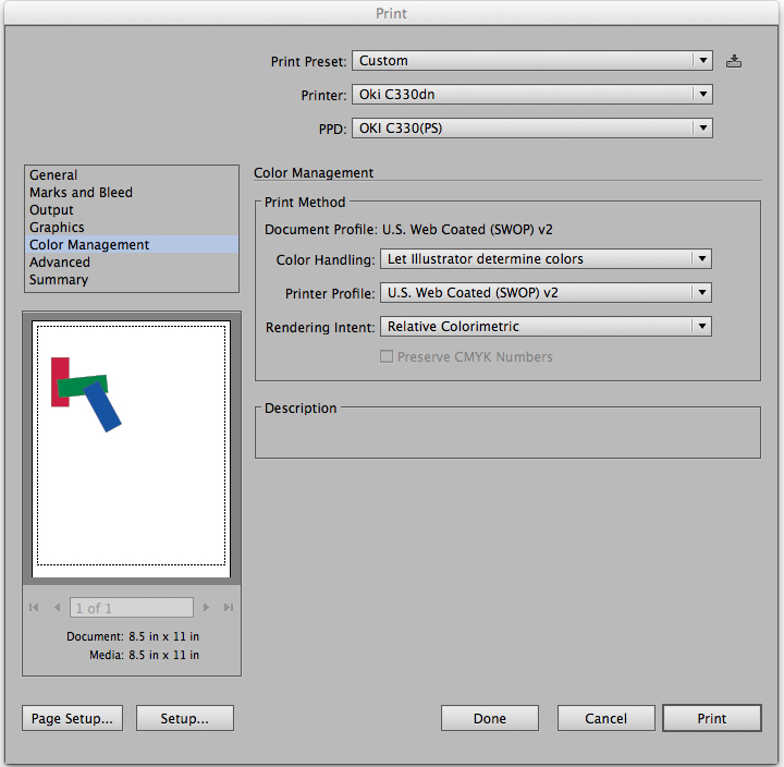

    I remembered that the files (all customer supplied) were RGB. I just thought I'd double check the colors and see what Pantone color they were close to. I have a script that does that. When I ran the script, it said it was a spot color and it could not be converted to a Pantone color with that script (it tells you what the closest pantone color is to any swatch).
    So I used the magic wand, picked all those colors and physically changed the colors to the pantone color. I used Tim's settings and I printed again.
    Exact same result.

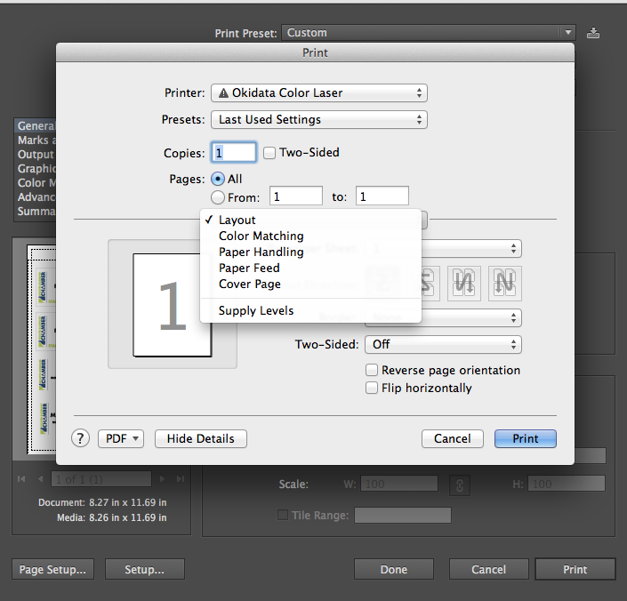

    So... the dot pattern in the green & blue are normal, right?! You are using CMYK to make a certain colour and the dots are normal... Your green is 29% C and 100% Y, thus the blue dots in your yellow to obtain the green tint you need.
    Not sure if you've tried the higher res setting.
    Click the "SETUP" button on bottom of the print dialogue page...
    Click the drop-down menu that says "Layout" and select "Printer Features"...
    What is your print quality set to?
    I tried it at the default and came with the same LARGE dots you have.
    I changed it to "ProQ2400" and it is much better.
    Give that a shot and see if it gives you better results... let me know... :rolleyes:

    Ah Ha! Just as I keep telling OKI tech support. I'm MISSING something!
    On my dye sub printer, I have that "printer features" option, on this printer, I don't.
    See the screen shot.
    I kept telling them "It's like it's printing at low resolution".
    Thanks Tim!
