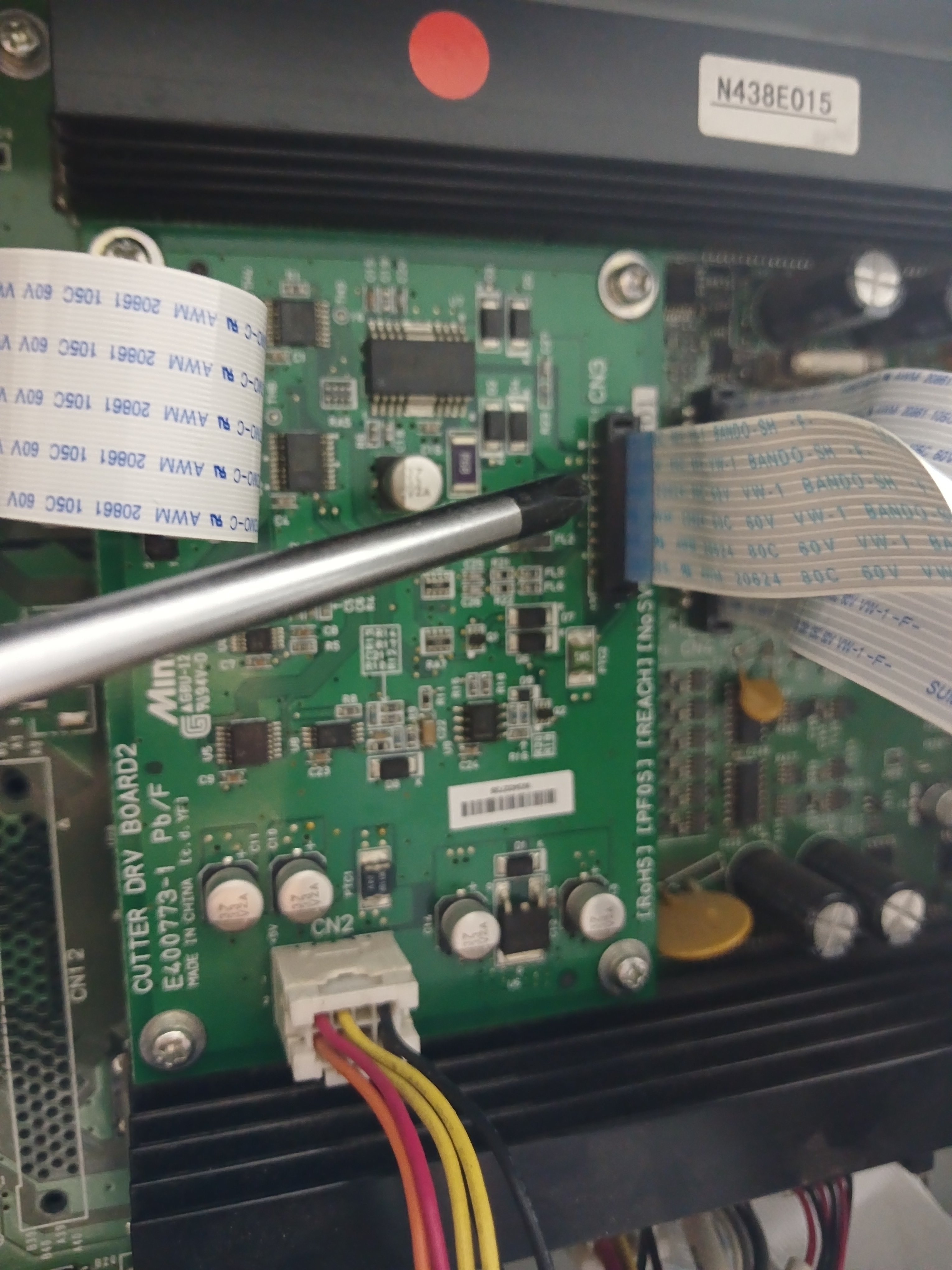

    you need to change the slider board
  16. kensign
    kensign Member
    51
    6
    May 22, 2018
    seattle
    You could try a new print head on,Change the memory board and memory cable , slidering board.
    will work, email me , signtech@shaw.ca
