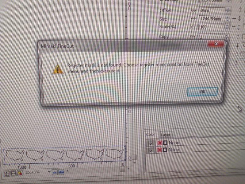

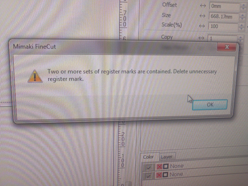

    I hate the rl button on finecut. It seems to hate me. Lol. I have to export the file and open manually in rasterlink. Rip n print. And then cut with finecut using plot selected button. I keep seeing these images when i try using the rl button in finecut with corel x5. I'm thinking its my design, because when i send a normal jpg without messing with it. It seems to work fine...anyone else see or know about these error messages?
