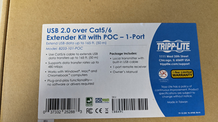

Now 2 man hours into the change...set it up and seems to be running alright. This is what they sent me. Colex Upgrade.jpg
See if it lasts....
