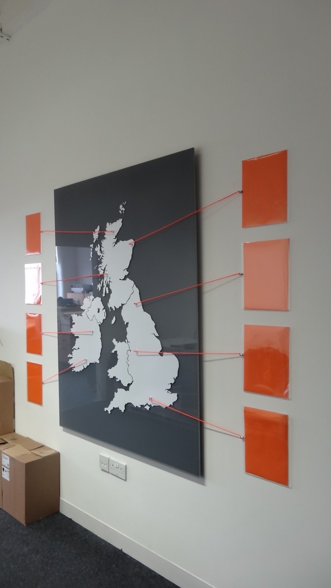

    In the UK you can purchase a ferrous vinyl sheet that you stick to the substrate and which magnets work on just fine. Here is a photo of some we used to make a map on 10mm acrylic
