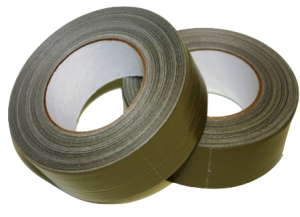

Gino, you can't get mil-spec duct tape in PA?
They don't call it
100 MILE AN HOUR TAPE
for nothing......
