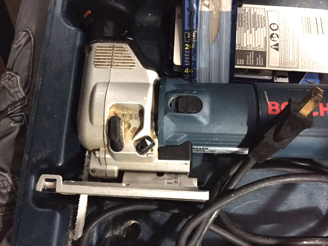

If you have to use a jigsaw, buy yourself the Bosche, 1584AVSK
Bosch Barrel Grip Jig Saw with Case 1584AVSK reviews | ToolWise.com
Hands down the best tool for the job, and I have used about every brand made...it has a blade angle adjust that minimizes chipping and cuts extremely fast
and of course with the correct blade for the substrate, it will work wonders
