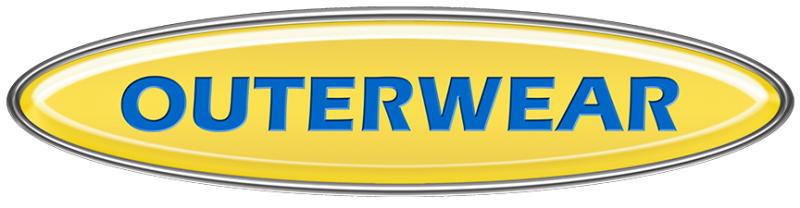

    Sorry you are right you said Joker my bad but he isn't that either. Sadly a drill, ruler and pencil are the only things on your list we have. Boss is out now looking for the cheapest solution to our problem in the mean time I have cut another one using a utility knife instead of my Olfa silver. BTW attached is an image of what i am cutting is is only 18" long x 4" tall and those sharp turns are killing me.

    See, if he wasn't such a joker/jerk, you could rough cut them in with a knife and if you had a disc sander, you could finish them off real nice with little to no fuss at all.

    What thickness? If you are cutting 2 mil you might try cutting on your plotter, high pressure and step your depth ... set your plotter to return to home and cut maybe 4 times....but Do NOT cut all the way through...basically cut deep enough to snap it cleanly. I do this with polystyrene on small jobs.

    3mm actually. And to all the haters my boss is learning same as me and as you all once did we are not born knowing these things that is why Signs101 is such a great resource. Boss man just brought back a saudering iron with a x-acto type blade on it. This method is slow going but easier on my hand. He is aware that in future we will either need better equipment (and somewhere to put it) or we will have to sub it out.

    We cut 3mm shapes like that with a trimming knife all the time.
    I think you should probably harden up a little.
    Do a light pass to set the path then a couple of heavier cuts and you're done.
