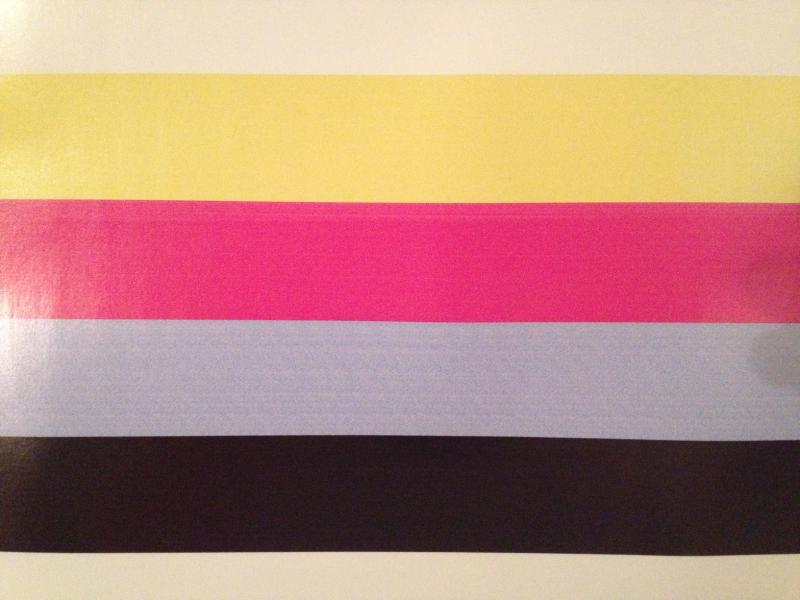

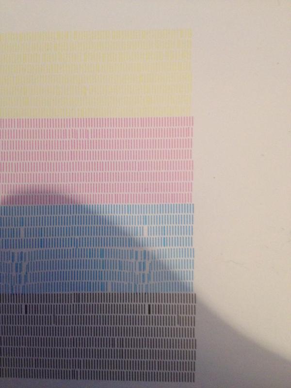

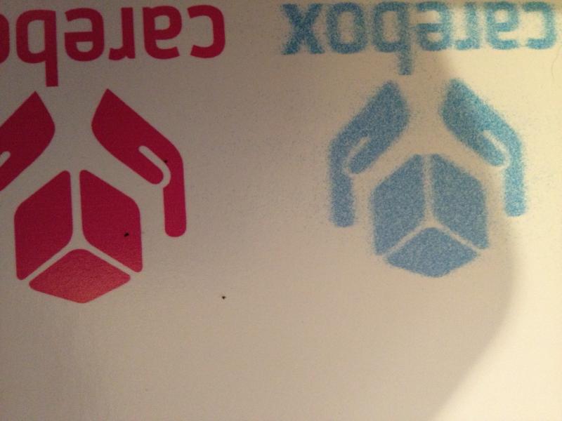

    Hello Everybody.
    I'm have an issue with my printer, I have a vp-540 with triangle eco sol EDX Inks, using stock versaworks profile.
    I just changed the cap tops and the dampers are full. The Issue is the cyan is printing at about 20% saturation.
    Any thoughts or opinions greatly appreciated

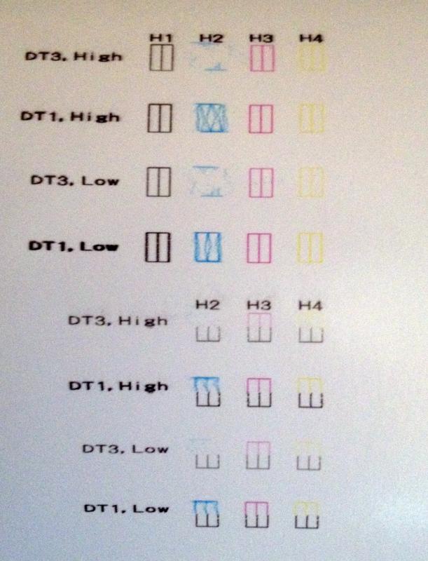

  2. FrankW
    FrankW Very Active Member
    1,037
    53
    48
    Oct 19, 2008
    Switzerland
    it looks like that the Cyan-head has an electronical problem. A print of the Service Mode nozzle test could give more information.

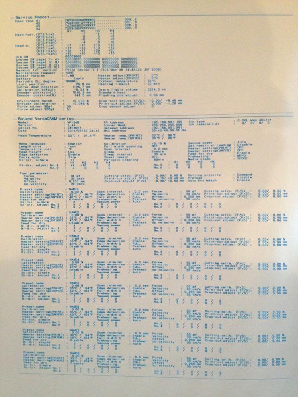

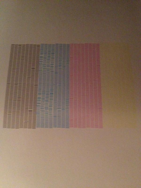

    Print Head Test Pattern
    Any thoughts?
    Thank you

  4. ligonr
    ligonr New Member
    10
    Aug 1, 2012
    the print head is deflecting could be caused by the wiper or it is not sealing well on the cap top you could try to flush the head and see if you can get some nozzles back
  5. OrderPrintShip
    OrderPrintShip New Member
    11
    Mar 5, 2012
    Thank you for the response ligonr, I just changed the wipers and caps. Gonna try a flush next.
  6. kffernandez
    kffernandez Member
    311
    1
    18
    Jun 26, 2010
    Philippines
    ive had this problem before. it ended up with me replacing the head, and hope that it wasn't a bad batch of ink that caused it.
    i'd appreciate it if you can keep us posted if head cleans and soaks improve your output.
    thanks!

  7. inkmed
    inkmed Member
    268
    Jan 4, 2010
    It is nozzle jam, but not very serious. Just try flush it.
