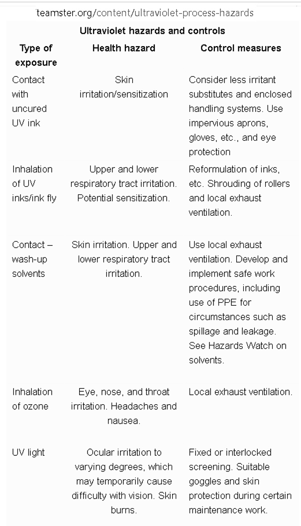

Yes, the way you are describing it, that does sound dramatic...but it was direct line of site as I could see the entire printer and the lamp working on the job, and the sunburn effect on my face was not imaginary...lol .There are other exposure hazards that should considered as well...Inhalation of mist Ink and ozone, contact with uv curable inks...as per this site below.
https://teamster.org/content/ultraviolet-process-hazards
