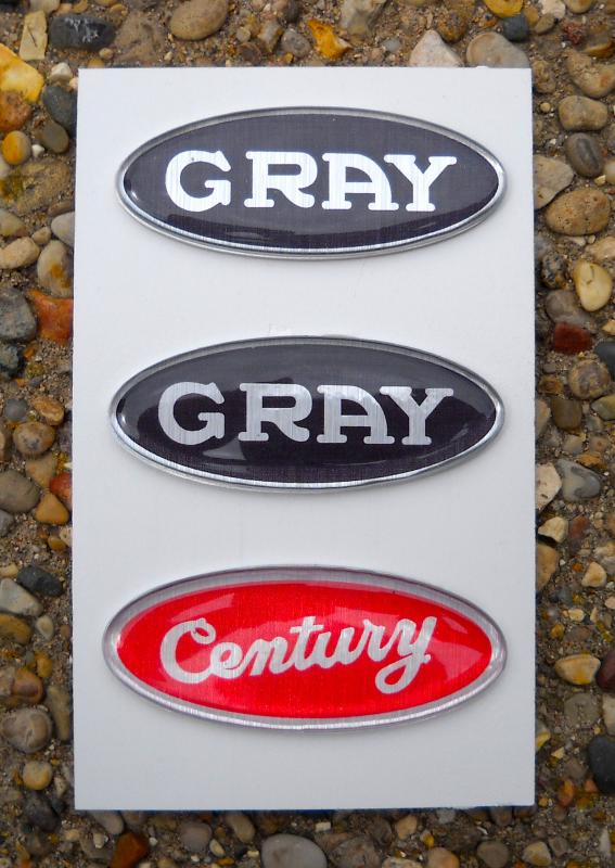

Thanks to Pat White, petepaz and the rest that offered advice ideas with my doming issue. Here is the result. Doming 900x600.jpg
Had a couple failures, but know what happened. The printable brushed material I use needs to be mounted then domed.
Still happy with the results.
rjssigns
Thanks for the kind words. They are dash badges for antique boats. We digitized the lettering, had the tags laser cut etc...
We were doing this:frustrated:at first. Then Pat and petepaz said brushed poly is touchy to dome and failures are common. Spot on with that analysis.
Out of 20 we binned 6. I'm happy and the customer is ecstatic.

Roland Sp540V with Eco-Sol MAX ink. Brushed poly prints beautifully. It's the doming part that causes fits.
As I'm typing this I may try printing on clear then doming. Easy enough to put a brush finish on aluminum or just use brushed stainless.
Probably double hit the print for some density but let the finish show. Whaddya think?
