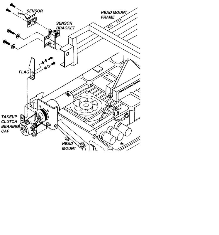

I wonder if your Z axis sensor is bent, or in the wrong position- If the head isn't lowering down enough- then the foil isn't making contact with the platen. I would take the top cover off, and watch it lower and print first:
For an LE:
I will try both suggestions tomorrow. I printed a couple jobs on it two days ago and it worked fine, so it's odd that it won't work today. Not to mention this is a very low usage, like new machine.
