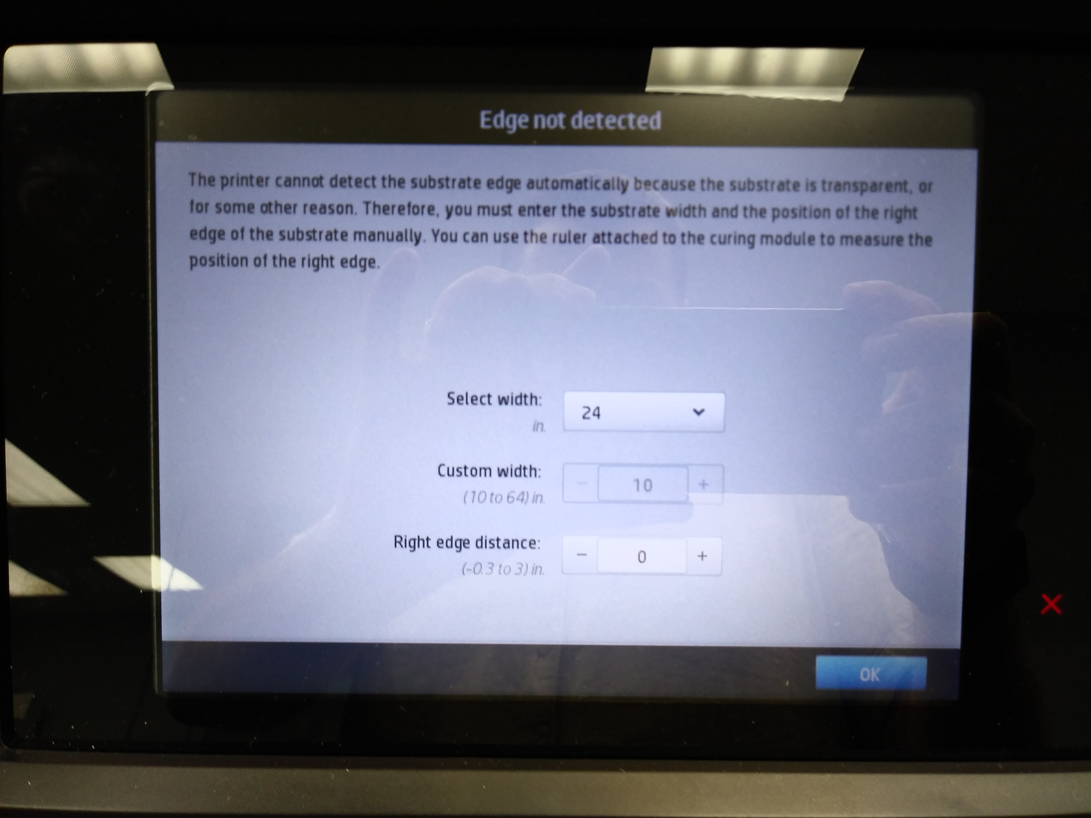

We had some downtime last week so I did some routine maintenance on our HP 360. I cleaned the encoder strip, and the line sensor by the underside of the printheads, but now whenever I load a roll of whatever media it cannot read the width and I have to enter it manually. Has anyone has this happen to them? Something I did or something I can do to fix this?

Here is a pic of the message I get.

Not trying to say it was your fault, but what was your process for cleaning? Could you have smudged something over the sensor?
Lea Marc
I used isopropyl alcohol as recommended and have tried once more just in case it made a difference but no luck.

did you pull the maintenance station out to clean the sensor. there is a Philips head screw on top holding the sensor in place. you can pull it and see if something is stuck to the bottom. could you of bumped the connection to the sensor?
Lea Marc
I did have to pull out the maintenance station, will check on the screw.
