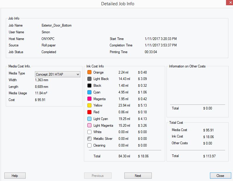

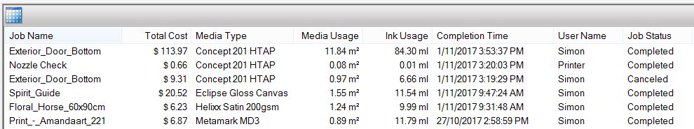

SignMeUpGraphics
Super Active Member
Solock, that's pretty close to the mark. I was giving a nice worst-case scenario with nearly full black coverage to show maximum possible ink usage.
Here are a couple of screenshots from the Epson "LFP Accounting Tool" used to pull this data directly from the machine after job completion.
Print summary:
Job detail:
