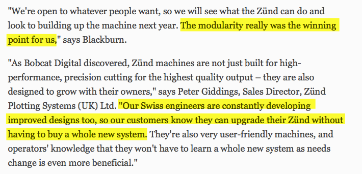

Zund claims to be the most versatile and modular system in the market.....FYI
See attached for what Zund upper management is stating in magazines and to customers/prospects. They've been doing this for a while....telling people they don't need a laser, and now they are trying to release a laser. The G3 is 10 year old technology, MCT has released two machines in a total of 3 - 4 years....all because MCT designs/engineers, programs and assembles EVERYTHING in house. Very agile, and we keep our finger on the heartbeat of this industry and it's needs. Imitation is the best form of flattery (SGIA: Zund TRIES to release a laser and bigger router...both items MCT is beating them on). Zund cannot hang a large laser and router on their current beam/gantry...it will not support it, so that means a whole new machine. See an email from a Zund account manager below stating this, and contradicting the attachment.
