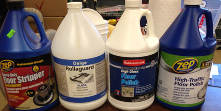

most of those clear finishes are made from acrylic polymers.
They use various solvents to vary drying times.
Future floor wax is one of the most common uses for the acrylic polymer. It is clear in the bottle because of the solvents used to make it.
In fact nearly all industrial strength floor waxes are acrylic polymer of some sort. Rubber maid has one sold at Home depot that is as strong as they get.
A Gallon of it is about 30 bux verses the high price for those other name brand laminates used in sign shops. We all know it repels water and is very tough. It takes a specific stripper to get it off the floor.
So why not use good old industrial floor wax for a far less expensive laminate that is just as good as anything that costs 4 times as much.
Its all the same stuff. Acrylic polymers that dries clear.

Over the years we've used quite a bit of clear shield products. In fact, we still keep a case at a time of the rattle can solvent version... ClearJet. Great stuff. Also, keep a gallon or two of Frogjuice in quart cans and diluted to varying degrees depending on the need.

It is actually an acrylic paint. Just as that expensive liquid lam is an acrylic paint.
Have to be sure not to get Floor Wax. Floor wax has carnuba in it.
PRoduct such as Pledge Future floor polish is a clear acrylic.
Then we can look at something like ..
Smell your water based liquid lam and then smell your acrylic floor polish. You cannot tell the difference.
They are dissolved with dipropolyne glycol ethers, and other ether based solvents...
Look at the msds for clear star and then look at the msds for acrylic floor polishes such as Rubber Maid Commercial floor polish. They both contain the same solvents.
They both are milky white in color.

abrasion resistance is an unnecessary worry in my opinion.
Water based liquid lam is a thin plastic layer a mill or two thick in one coat and a few mills thick in two coat's. I used it in places where there is no worries about someone scrubbing the piece.
I've used some type of floor polish over ten years and never saw a problem. I tested it on my own trailer with encad print that lasted two years then it was was changed but still looked good. The un-coated side lasted about 8 months at best.
Water based frog juice uses Diethylene Glycol Monobutyl Ether as a solvent (and a few other ether and alcohol things) Just like some acrylic based floor polish. Hmmm?
If a commercial floor polish is tough enough to resist people walking on it for weeks and months then its is certainly tough enough for most graphics. Yes?
Is it for every thing. Is it the end all cure all? Nope. As with any product there are choices to be made.
Oh by the way. One can add some mica powder and color it too.
Here is what I been using for a very long time. If it takes a special stripper to get it off a the work table then what is the worry about abrasion resistance.
Smell them and one will see there is no difference in the odors.
