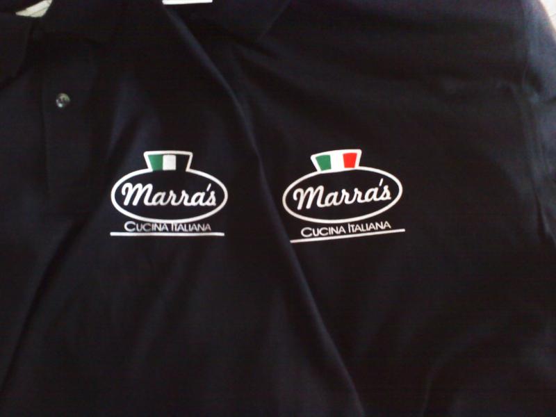

I am applying a small square piece of red and green Fibron Over White Fibron, The Green Is Sticking And The Red's Not! I have To Repress The finished Piece with another 14 Seconds.....It seems to be working but will it come off in the wash and will I have to do this job over? also I made a cutout so the red and green will go right on the shirt but the red will not stick at all??? I atached a photo to show you.....Phil

i layer fibron almost daily. are you pressing it right from the carrier? i have never, ever had an issue with layering red fibron over any other color including white. not very helpful, i know. but it's really idiot proof stuff. maybe there is something wrong with your particular roll that you got from fellers.

I think you may be right....I am presing the red on white 2 times and a little hotter and it seems to be working...gotta wait and see If It comes off In the wash....Thanks
