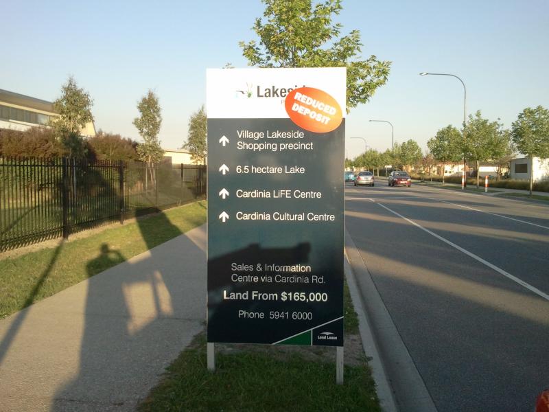

    Drove past a few signs today that are composite panel fixed to a 2" box steel frame, i can see that theres no fold on the edges or screws , how would this be fixed to it?
    vhb tape and epoxy?

    ill drop past tonight and take a pic. from what i could see, there was no evidence of fixings, and being double sided, surely tape on its own would not be standard practice.
    its a full laminated print on alucabond (composite aluminum) so i dont think they would of used bondo on this one.

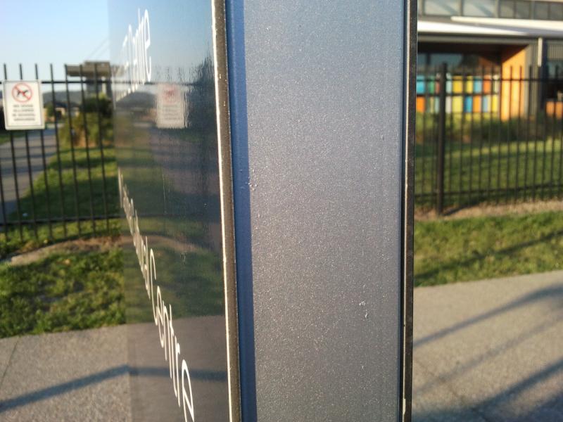

    heres two pics i took
    would epoxy be that strong to rely on?

    VHB tape. I wouldn't bother with the epoxy.

    That's VHB IMO. The space between the post and the panel is equal (and similar thickness to VHB) on both sides and all the way up and down as far as I can tell. With epoxy or adhesives you'd probably see some variation in thickness and probably a little that came out when pressing the panels (even if it was wiped up - you'd see it right at the edge of the post and panel.)

    VHB...that's all that would be required and what is typically used for signs like that.

    VHB tape for sure. I was at a trade show and the 3M rep had two peices of aluminum held together with VHB. He put them in a vice and cranked on them. The aluminum broke but the joint held with the VHB stayed together. Try and remove some and you will be a believer!!!!
    Just let it set up 24 hours and it is there for good!
