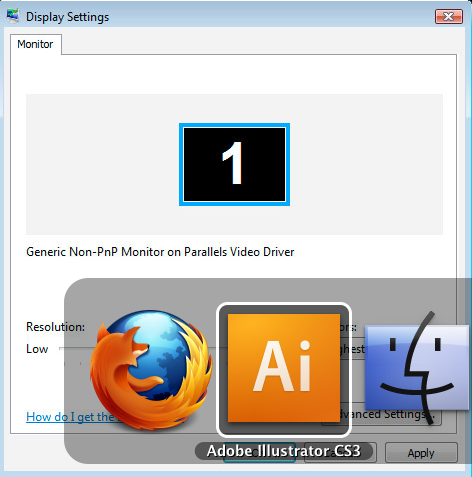

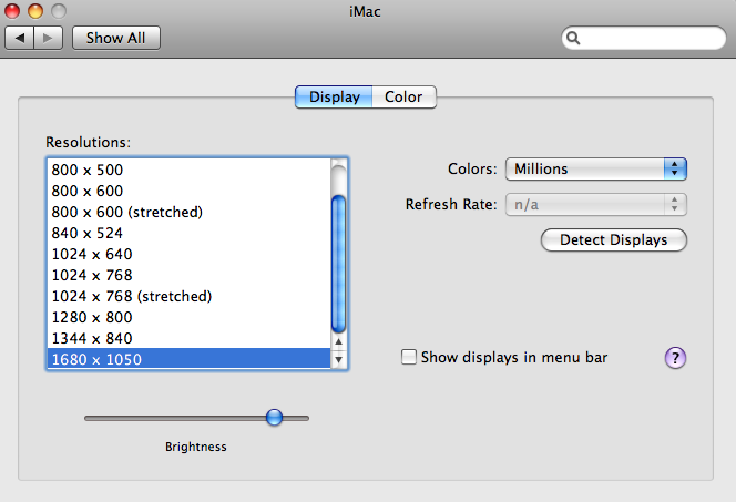

size doesn't matter.... you can get a widescreen and just change the resolution until you find one that looks right for your monitor/tv:
Not a great habit to get into, LCDs have one native resolution and any other resolution is scaled. What he's probably referring to is the screen ratio, his TV's ratio setting is probably set incorrectly (most new tvs should have an auto-detect, use that...). If it's set to anamorphic and he's watching a standard 1080P broadcast it would look stretched, etc.
