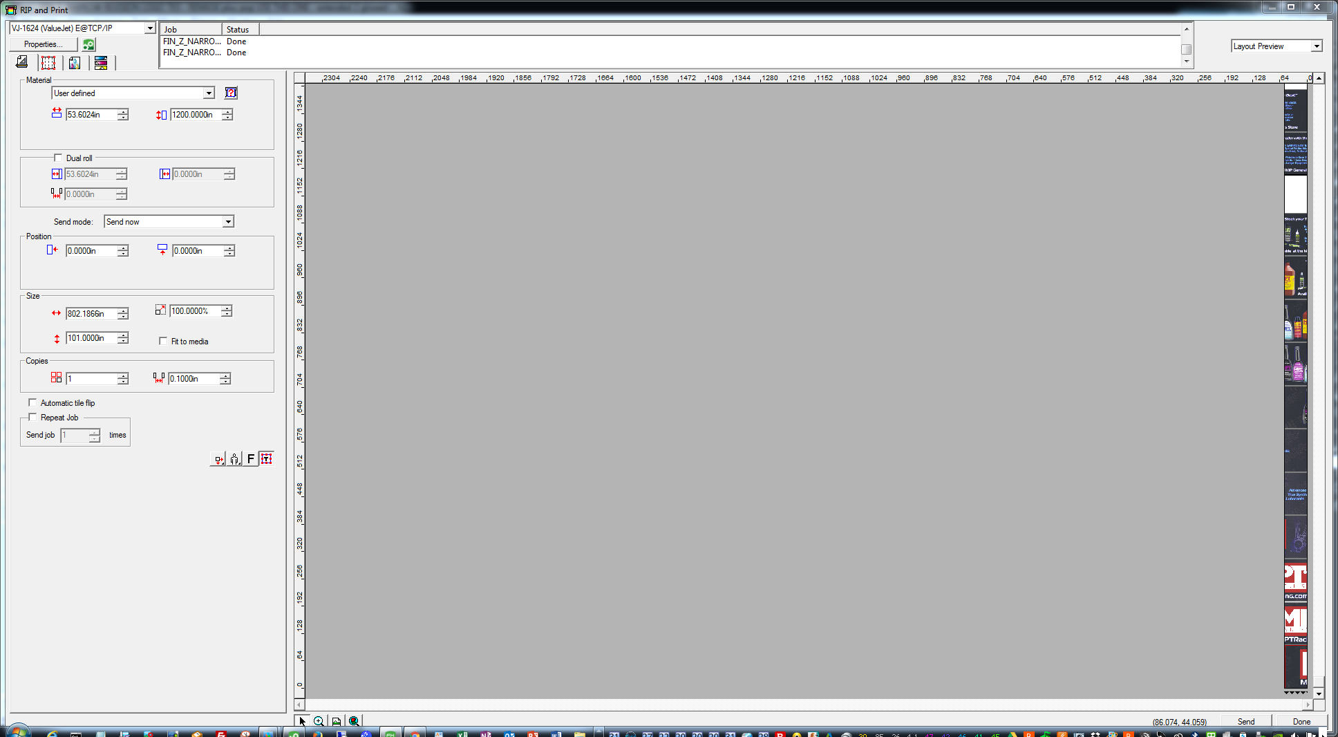

Anyone know why flexi is adding a white panel into my print job?
(please see attached image from production manager, blank section is 3rd row from the top)
- It is a 57 foot long wall job.
As always, thanks in advance for any replies
This is most likely due to you having 1200 inches set as the roll length and the artwork being over 1300in when paneled like you have them. Poll the actual roll size from your printer or manually adjust the roll length. Then the space will go away. PM is thinking that there isn't enough space, so what you're seeing is "the end of the roll" gap. If you zoom in you'll see a black line and some grey space denoting the start of a new roll.
