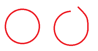

I'm looking to improve the quality of our cut. Currently using the GX24 (Now rarely) and the SP300v for cutting only. We are doing very intricate cuts such as mobile phone wraps etc. We get issues such as
- Circles often don't join, example.. (Ignore my paint skills!)

DiNoc is somewhat thick and a different composition to the regular cut vinyl. A normal 45" blade should cut through, but you might try a 60 deg blade. Good blades stay sharper longer, and they aren't cheap. The cheap ones on Amazon are cheap for a reason. Probably due to inferior steel, sharpening and QC.
Typically when the blade doesn't close a shape, it's because you have the blade offset set wrong. Offset is the difference between the rotational center of the blade and the cutting point. Your cutter manual and specific blades used will dictate the offset.
