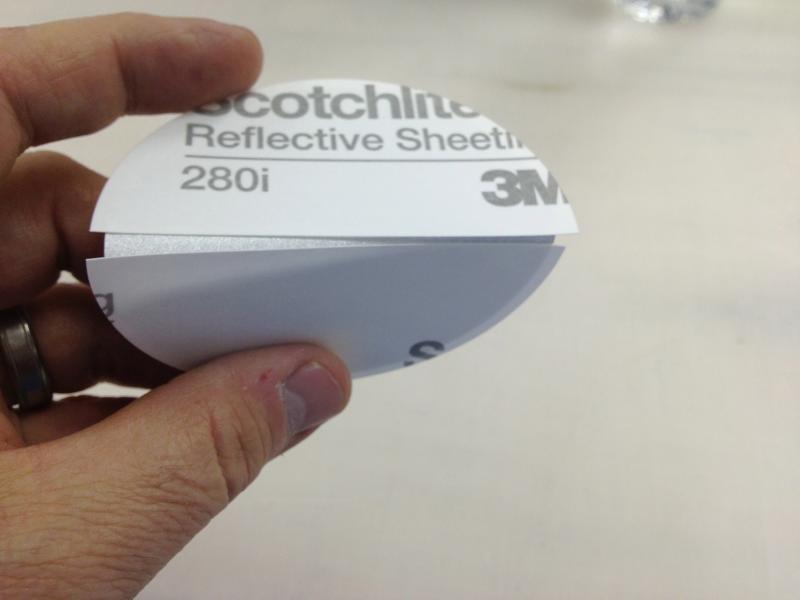

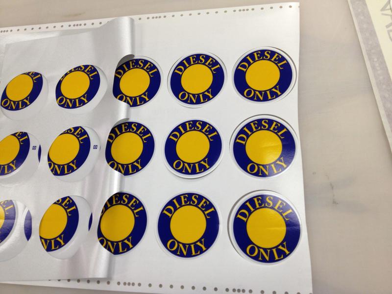

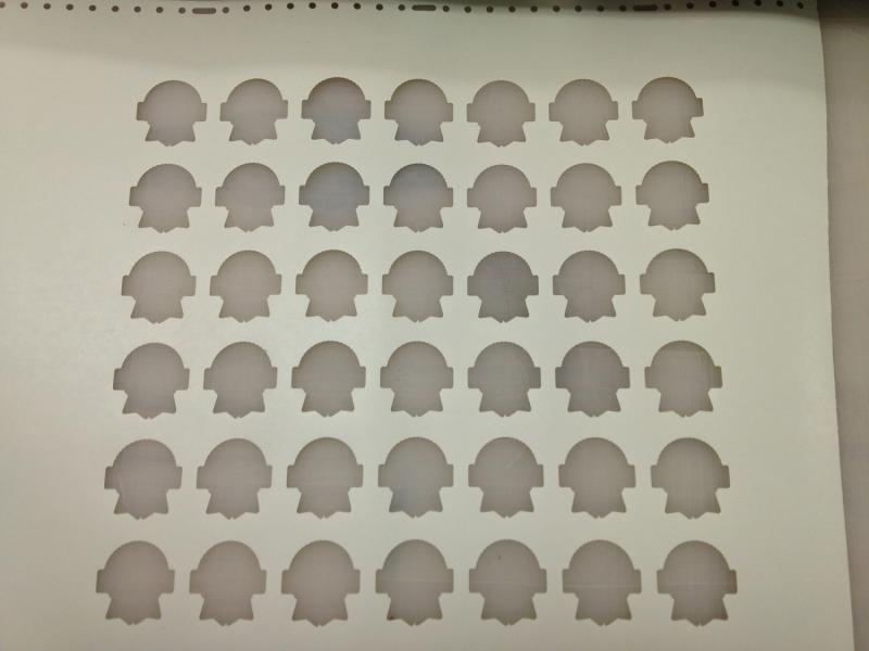

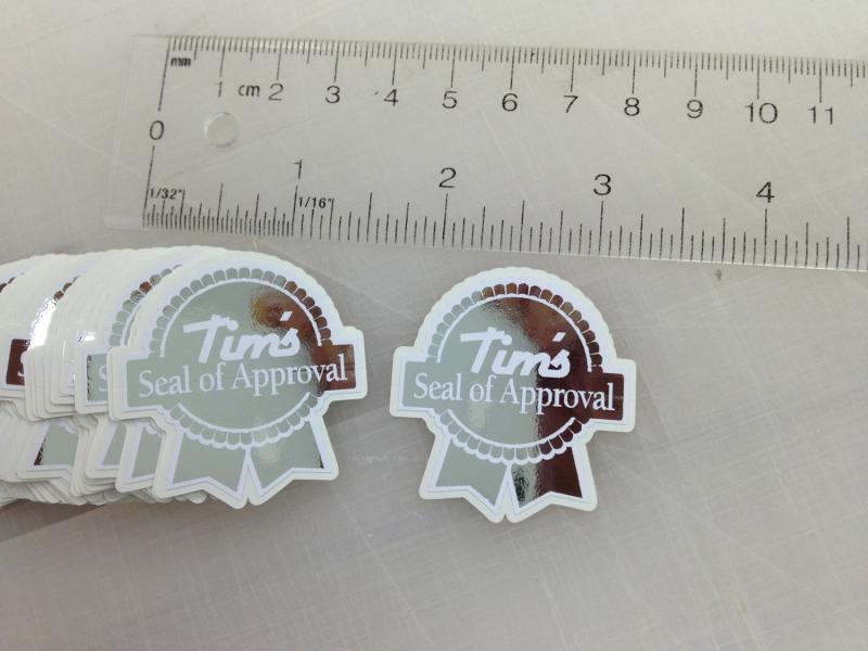

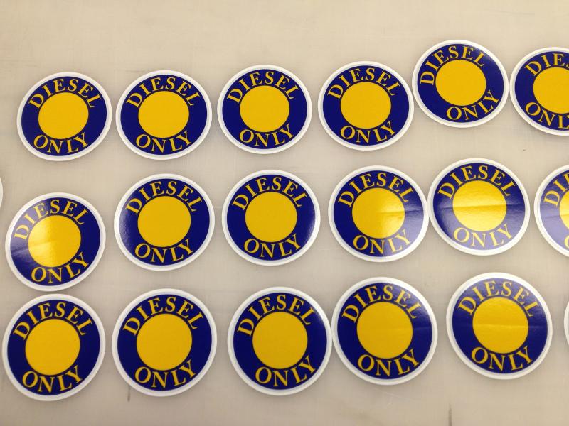

Wanted to show off these (simple) little shape cut decals I just finished for a customer. They back-cut like a charm! I was actually surprised as to how accurate, fast and very clean the back-cut went. For those using Gerber/Envision and not using the back-cut feature... why not?!! :thumb:

I don't have the envision plotter, or a new enough version of Omega to do this, but wouldn't this chew through blades and cutting strips very quickly?

That's a nice clean cut, also were they printed on your latex printer.
No, these were printed on the Gerber Edge FX. White vinyl with Silver Metal foil.

I carry 2 blade holders... one for front cut and one for back-cutting... and lots of spare blades (now that I've discovered GMS.com!!). I've back-cut maybe 50 jobs in the last 6-8 months and have yet to change a blade or strip. If the force is adjusted just right, and the blade depth is spot on, it doesn't wear them out too much at all!

So you just use an old 30 degree blade for the backcutting?
Yep... it seems to stay sharp for a long time when back cutting. I would imagine you'd need something a little sharper for back cutting intricate shapes though.

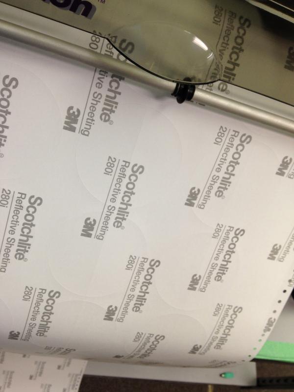

Thought I'd share another back-cut job printed on 3M 180i Reflective Sheeting. Obviously I had to adjust the cut forces, but worked like a charm! Back split for crack'n'peel also! :thumb:

What thickness of vinyl are you using? I would think that 2 mil thick Scotchcal 220 is too flimsy to apply without application tape.
I use pretty much anything! 220 works just fine (doing a 2,000 1" x 2" job today) and it's working well. Key thing is to make sure to leave enough room in-between decals for weeding ease. Sometimes I even "sacrifice" one row to add more space for ease of weeding. The time saved is well worth the sacrifice. I back cut 220, reflective, 3M SC50, Convex High Bond, etc... just need to adjust the blade depth & force accordingly to your vinyl and backer thickness. It is definitely a learned skill, but very, very doable!

Do you have to flip the file yourself for the crack-n-peel backs or create a seperate (cut only) file for this operation? Or does the software know what you're trying to do?
How do you get it aligned easily with the material flipped over? The 280 would be hella hard to see through.

With Tim's encouragement, I tried my first backcut on my envision 375 yesterday. My technique showed promise but still needs some work.
The backcut was not quite deep enough to separate the decals but apparently deep enough to show an impression on the front of the decal as a result of the slit cut. Decals were too close too. Maybe my blade wasn't sharp enough.

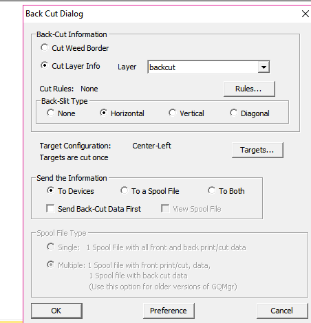

Tim those decals look great! A little envious about how easy it sounded for you to do them though haha ... I am new to the print / cut world and tried back-cut decals today for the first time with a little less success. I appreciate the advice on getting a second knife holder, that i'm sure would make a big difference for me.
I am using Omega 5.0 and Gerber GS15Plus. I set the job up using the GSPlot BackCut Dialog box as described in video : Custom Backcut - YouTube
But for some reason it did not cut the horizontal back slit even though I'd selected it in dialog box : snipit.PNG
The cut through the paper liner was not deep enough either. But I'm still uncertain whether that would require more knife or more force (still new to me). I tested the knife blade depth by running it along the paper liner of the permagrip product i'm using (on top of a cutting mat) and it seemed to cut the paper but not the vinyl when i did this by hand, so maybe more force req'd? I have it at 2 and it is a relatively new knife.
The other thing i was unsure about was whether I should be pressing SWIVEL KNIFE mode or just INIT KNIFE before cutting the paperside/backside of the job.
Any thoughts or advice would be appreciated :smile:
